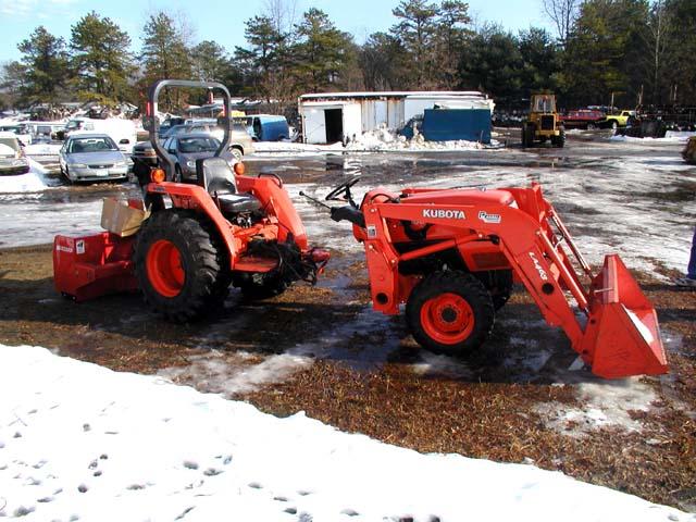

isnt this the tractor that someone thought was fake in a earlier post,this is from salvage direct a wreck auction

It would be nice to know what happened so I can avoid what ever activity it was.
It was a vehicle hitting the front of the tractor while he was at the end of his driveway. The vehicle lost control and went off the road and hit the loader.

And here I thought is was what happens when you back drag too quickly and snag an immovable object with the FEL :eek:

If it's the same tractor..... the owner is a member here at TBN. I remember it like Robert in NY does. The tractor was only a week or two old and it was a neighborhood kid driving the car. The driver/owner of the tractor was amazingly & fortunately not hurt from the impact.

Wow! First, it's amazing that the guy was not hurt. Second, the car hit the loader, but it appears to have no damage. (Just talking about the physical structure of the bucket, anyway.) That's outstanding. I think I'll buy this and make an articulated Kubota. :D

...... the car hit the loader, but it appears to have no damage.........
They didn't publish a straight-on view of the loader - it is almost certainly bent. The bell housing tore the front ears off the main transmission case - lot of damage, and some parts are missing. Clutches, pressure plates, etc.

Even if you wanted to fix it, probably the only thing needing fixed is the hogshead assembly area where it broke. There's not much holding a tractor together at that point. That's why they break there.

I think there is a lot more damage then you realize. Hopefully the engine block isn't cracked but looking at the front wheel it appears it took a shot so how much damage happened to the axle, steering assembly and the axle mount. You also have to wonder if there is any damage to the rear housing as this tractor didn't just split, it was ripped in half. It took a lot of force to do this damage and I am curious just how fast the car was going when it hit it. If whoever bought this tractor plans on repairing it then I hope they inspected it first.
