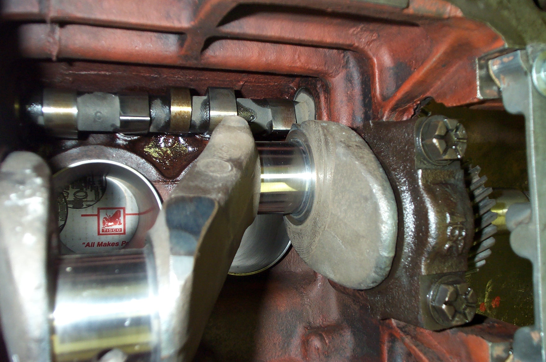

They are wet sleeves, should be an O ring holding them in. I've only taken out the sleeves with the crank out. Large block of wood and large hammer. They are much easier than dry sleeves! Here is a pick from a C-135 engine, on these the cylinder lip protudes beneath the block so you can whack it hard to get it going. Once it rocks, it comes right out. It would be hard to do from in the tractor without a real puller though...
Wayne
