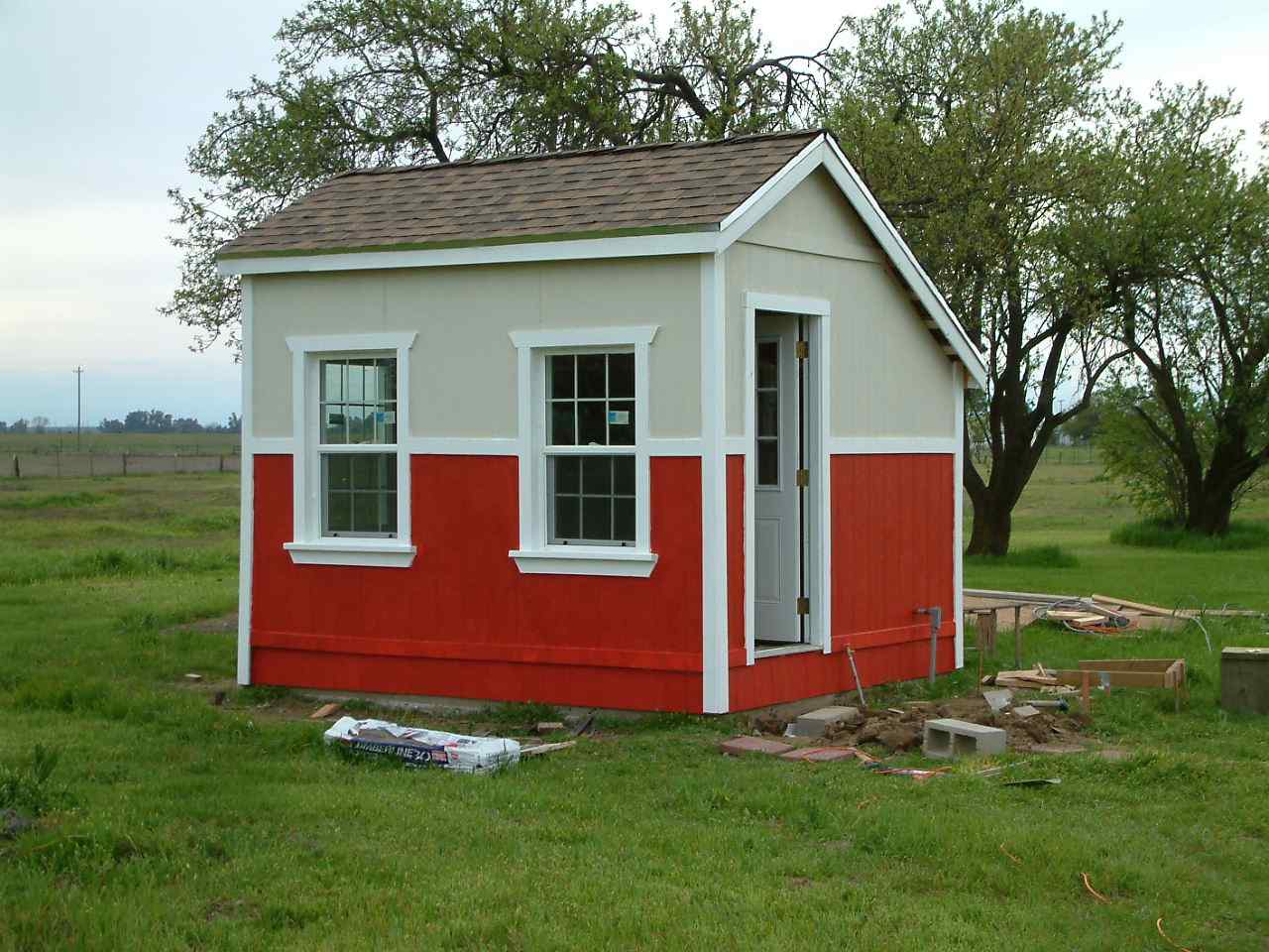

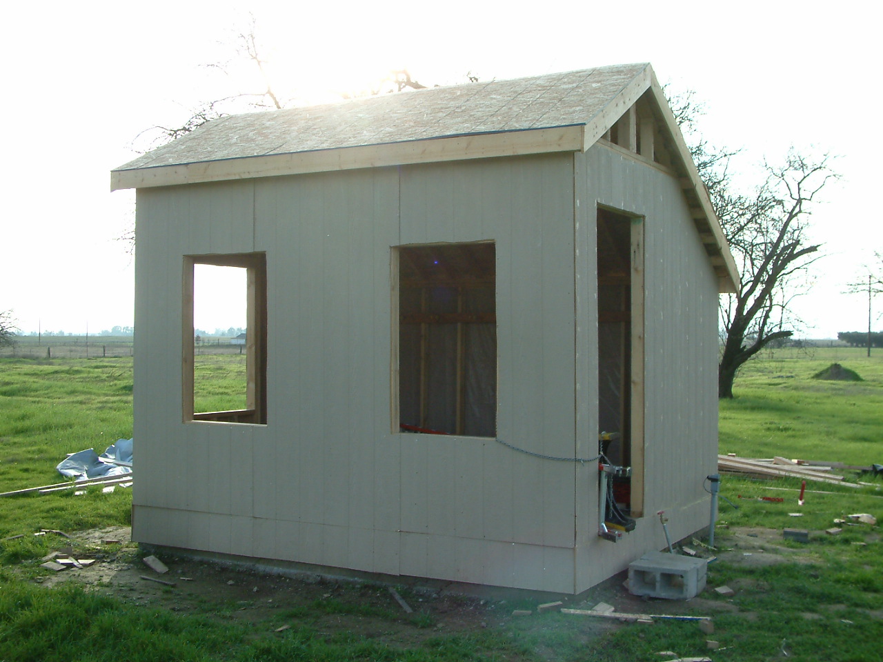

Get exterior grade OSB for the roof sheathing.
Painted OSB siding looks crummy. Use something like Sturdi-panel siding(Home Depot). I costs twice as much as OSB, but it looks a lot better painted.
Don't forget to add trim boards in the corners. Makes the job look really neat.
The two photos show an 10'x12' shed I built using the Sturdi-panel before painting and after the first coat.
