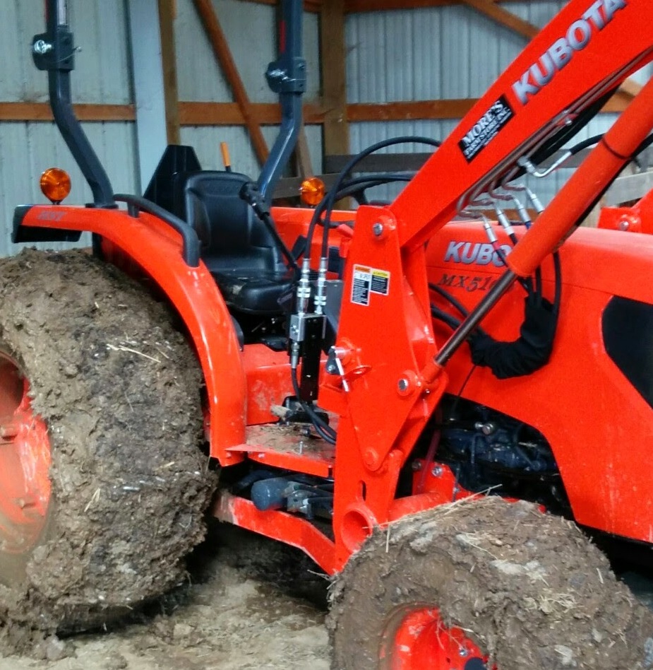

I got the same tractor this winter and am pleased with it.
I didn't get the 3rd rear remote, but the dealer's price was the same if I brought it in later and since I was feeling cheap I didn't get it.
I got the same bucket, but found that the bolt-on cutting edge was optional. ($200)
I did get a 3rd function remote for the front (but ran out of money before buying myself a grapple). However I found the
install somewhat awkward. There isn't an official 3rd function so the dealer used a kit and installed the valve to the
right of the rest of the loader valves. So the hydraulic lines stuck out and are more exposed than the ones for the loader.
The control is a thumb button which is nice, but it seems the valve could have been put inside the loader mount points to
be more protected. Probably the dealer isn't allow to tap new screws or weld.
This tractor is also on the light side so you really want filled tires. I paid $300 to get my rears filled with rimguard. (The dealer started at $500 for that option)
I also have a set of large chains buried under all that mud. ;-)
I haven't gotten the grill guard yet, but if I do I will take it to the local welder dude and have him add a mesh grill to get out branches.
I miss the fact that I could crash my old Ford into deep brush and not worry about hurting anything. The guard won't change that
but it might help when I forget. ;-)
The other option I am considering for the future is a sun canopy with some added lights.
