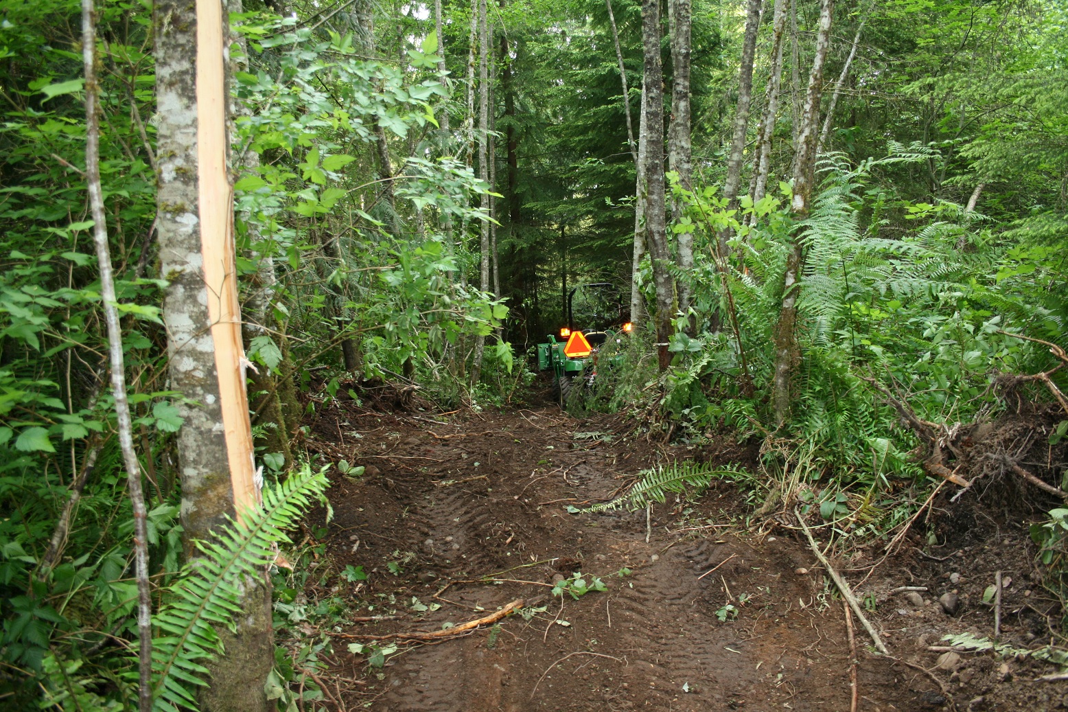

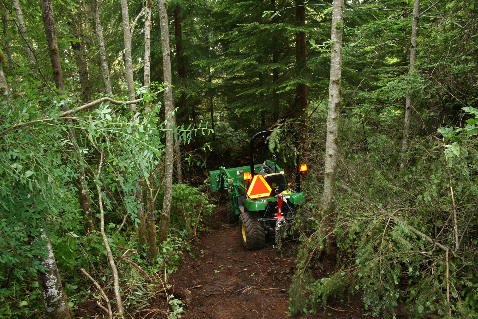

With a toobar you should have no worries. Cut a new trail through the woods with my similar model 2305.

Looks great! Any tips you can provide???

One thing to watch out for when using a box blade for balast in the woods, is that it sticks out more then you might think. Scrapped more bark then I intended from a number of trees. Don't be in too big a hurry, can't always tell whats under the brush. Keep the loader low to the ground. I made myself some quick turn around areas that came in handy. I incountered a lot of old fallen trees that I needed to drag out, so have a chain handy. Have fun, I know I did. Almost forgot, I mounted a skid plate to keep the small stumps, sticks and so on out of the low hanging hardware under the 2305. Your 1023 does not have the same issues with exposed filters and fans like the older models did.
