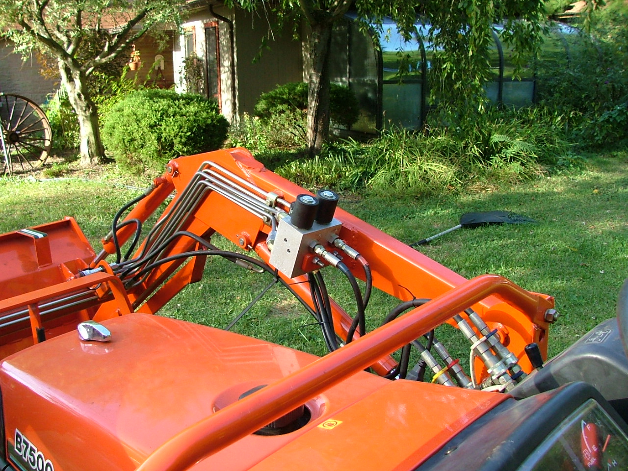

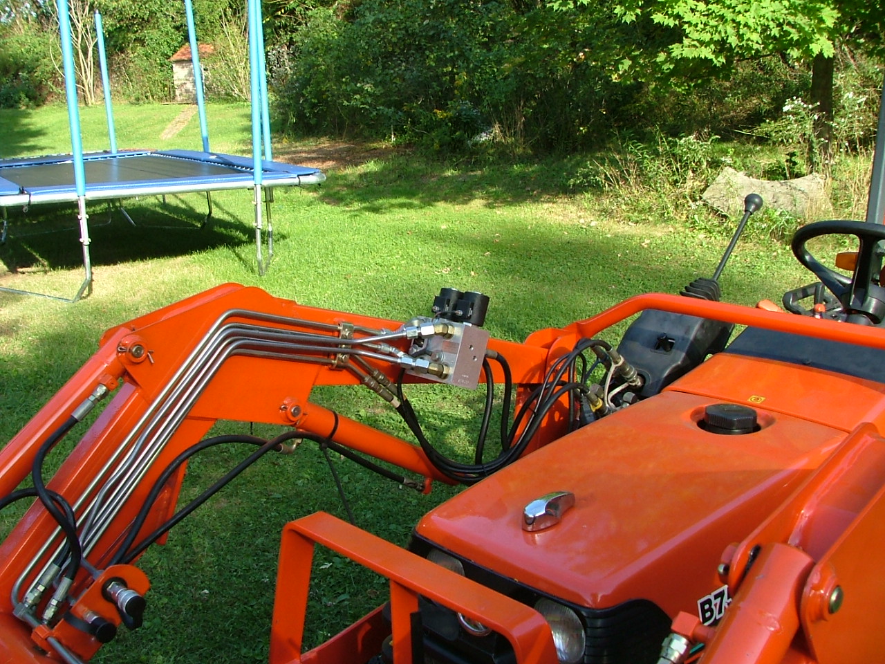

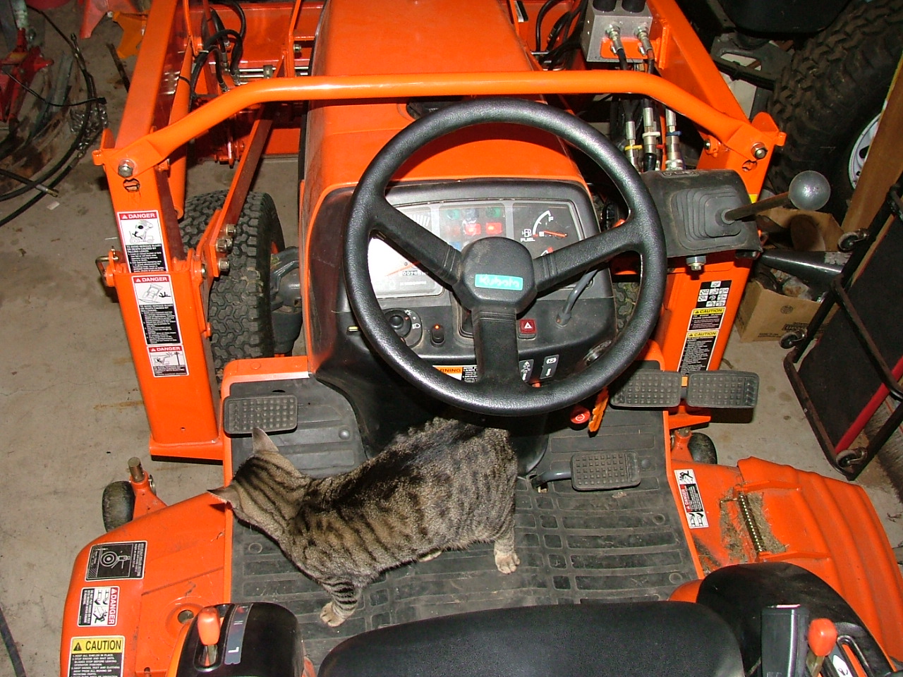

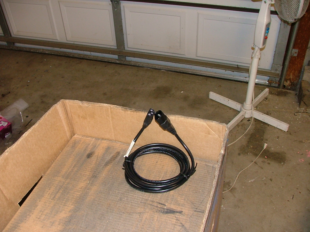

Placed the order on Friday, should be about 2wk ship time. Here's my set up, I acquired a Fasse diverter valve with another implement that was originally hooked to a JD. I used the bracket it came with and welded it to my loader arm, I did it this way so I would still only have 4 QCs when ever I remove the loader. I also modified the torque tube tubing hold down into a bulkhead for mounting the grapple QCs. To power the diverter valve I got a Bosch relay (readily available on EBay for $5.00), ran an inline fuse directly from the ignition switch to an illuminated rocker switch on the dash, I then ran my power from the relay to the loader using a power cord from an old computer, I like these because they are hooded and weather protected. I also ran wires for a second switch which will be a momentary pushbutton on the loader joystick. I found a B&M 80658 - B&M Shifter Knobs - ''T'' Handle Style that will work nice. Cant wait for delivery. :)

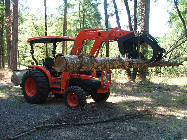

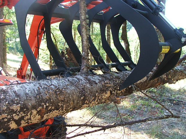

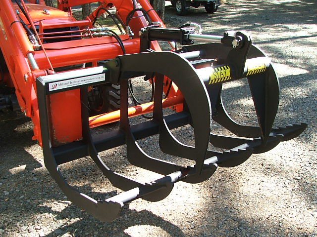

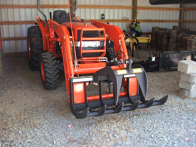

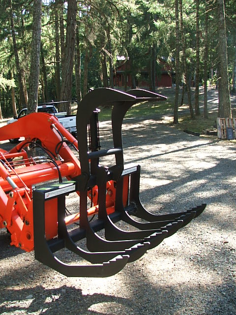

Good call. I dealt with John as well and he is very nice to work with. I'ts kind of interesting to see someone with your tractor get the same size of grapple I did. Based on the work I do I can't imagine needing anything more. You will love it.

I've had my Millonzi 48 on both a 21hp tractor (Kioti CK20) and a 41hp (DK40se). Works just as well on either. I also cannot understand why anyone would need a bigger grapple for a CUT.
