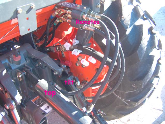

Walternva, other options you might want to consider:
1. A hook welded to the mid top of your FEL bucket (my dealer did it free and I use it all the time).
2. foldable ROPS if you don't already have them.
3. A canopy
4. For possible flats put a sealant in the tires.
5. At least 2 Hydraulic remotes, one for tilting implements forward and back and one for tilting implements side to side. (top and tilt). The dealer might be able to install the hydraulic cylinders that these remotes will go to. They will be on the rear three point hitch, one on the top link and one on the right link. See attachment photo.
Also complete as many of the non tractor jobs around the house that you can, because once the tractor arrives they will rob you of seat time. /forums/images/graemlins/grin.gif
