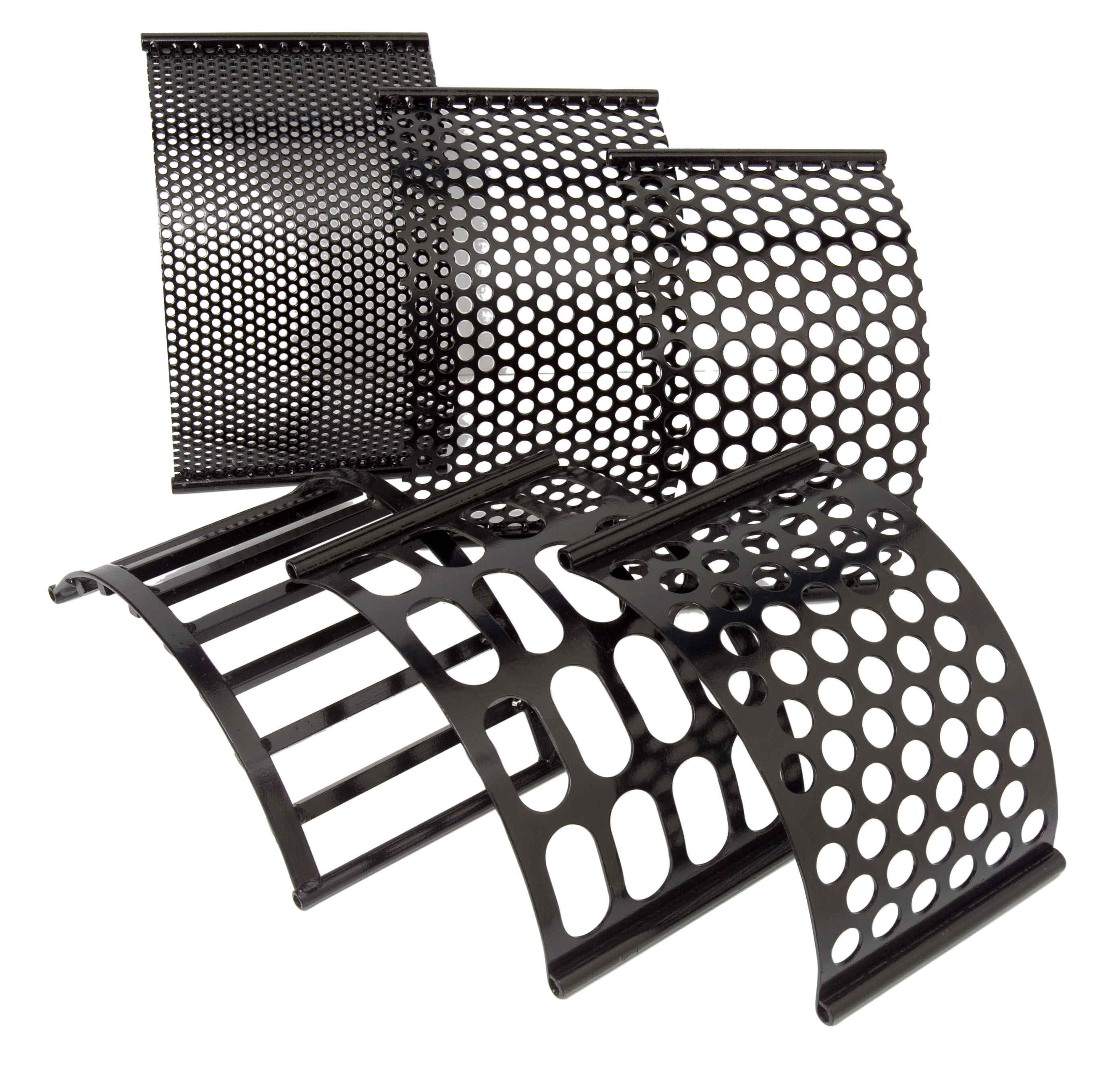

Found this photo of the screens.

Thanks for that pic! It's helpful to see the relative sizes. Glad I asked about these, since it sounds like I should be thinking about either the oval holes or barred model. I've seen no significant clogging issues while running green leaves through the 1" screen, but they're always going through with branches that keep things clear, I guess. I now see that damp leaves can be a real problem.
