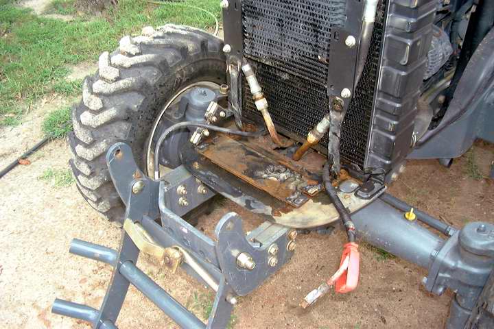

In my case, it was a day and a half. I recently filled my lead-acid battery just above the plates and the darn thing bubbled out again. That's the second time. /forums/images/graemlins/mad.gif The first time I got a new radiator and hydrostatic cooler lines, but not the battery shelf. This time when I removed the battery, the looks of the shelf made me cringe. /forums/images/graemlins/tongue.gif (see attachment)
Anyhow, I've been wanting to put a battery box in my tractor, so that's what I did. I'll make a separate post in the next few days and give the details of how I made it work. I figure the safest way for an Optima or regular lead-acid is to have the battery box. I just don't like the fact that rain comes in my hood and soaks the battery. If there is any acid leakage, it can only go one place, thru the radiator.
Anyhow, I used several wire brushes and some Loctite Extend to repair my shelf and other damaged components. I repainted everything and I'm really happy with how it turned out. My battery voltage was 12.47 volts, so I just couldn't see throwing it out. Even if I get the Optima, I'll use that OEM battery in something else. I'm cheap that way. /forums/images/graemlins/blush.gif /forums/images/graemlins/smile.gif

Okay, I don't want to hijack Big Dave's thread, but after posting such a horrible photo, I felt I needed to post a photo of my battery shelf after it was cleaned, treated and repainted. This makes me feel a lot better. /forums/images/graemlins/smile.gif

Jim I'm really surprised as you are the one that originally clued me in the the New Holland battery problem on my tractor. It's bad enough to do the clean-up once but twice??? I hope for your sake that the battery box takes care of the problem for you once and for all.
