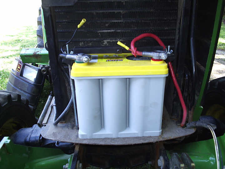

For those who were curious about the Optima battery, here's the follow-up to the replacement for my 4400. I ordered a 51R Optima battery. The R just means the positive is on the right and side as you're standing in front of the tractor. The 51R appears to be a perfect replacement in the 4200-4300-4400 series of tractors. It fits the compartment perfectly. Since the Optima is sealed, this should stop all of the problems of acid leakage in these tractors. The attachment is a photo of the complete installation.

One difficulty is coming up with a hold-down. Most battery hold-downs are designed to go across the short part of the battery. JD's original system are a couple of small clamps at the base of the battery, but the Optima has no provision to use those. I ended up using a couple of J-hooks fed through the holes in the base plate where the original JD clamps were bolted down. I found an adjustable plastic hold-down that, at it's extreme, would just fit across the top lengthways. It was unstable when pulled this far apart, so I put some Gorilla Glue on the two pieces and then ran a small sheet metal screw in from the side. It is shown in the yellow circle in the attachment.

I'm glad you didn't have any leakage problems with your original battery. Starting the tractor was never the problem. And if it was, I have a upright charger and could get the tractor started if that were the only problem. However, since I had gone through 3 of the StrongBox batteries from Deere (don't know how much they cost, they were all replaced under warranty) and they had all leaked and corroded causing damage to the battery tray and oil lines, I wasn't content to do any more experimenting. It didn't seem prudent to risk hundreds (or more) dollars of damage to battery trays, oil lines, oil cooler, radiator, frame, etc. to save a few dollars on a battery. I know from previous off-roading experience that the Optima batteries are as tough as they advertise. I don't even know how much the battery was, in total. I know it was $95.00 + shipping. Think it ended up around $115.00. I know this battery won't spew acid and they are extremely durable in high vibration installations. It is a deep cycle battery so will stand up to long periods of non-use better than standard starting batteries and if I have to buy a new one every four years, I'll consider it very cheap insurance.

Seriously, maybe I'm reading something into your last post that isn't there, but I get the impression that since you haven't experienced the problem, you may not be fully aware of what is happening. The leakage we're experiencing isn't the result of a battery case failure. Replacing a battery once a year would not stop the problem we have. My first damage occurred within the first month of use. There was no indication of a problem until I pulled the grill to do some cleaning. Dealer replaced the battery and removed the oil cooler, flushed, treated and repainted. The problem seems to stem from the battery design itself. The StrongBox batteries (and most aftermarket starting batteries) have the standard row of fillercaps across the top. Fumes vent from these caps and if the battery is shaken substantially during use, acid can be discharged from these caps. After the three StrongBox batteries, I purchased a maintenance free starting battery from a local dealer at a cost of about $45.00. This battery had no corrosion or leakage problems, but died after about three months. It was apparently not designed internally to handle the bouncing and hammering it takes in a tractor where the only suspension is the air in the tires. That's when I decided to invest in an Optima battery. Perhaps those of us who are having the problem treat our tractors a little rougher than those who don't. Some of the pastures that I bush hog will bounce you so hard, you definitely know where your kidneys are. Trying to get some of that wet Kansas clay out of the front bucket will bounce the tractor so hard, it looks like one of those hydraulic low-rider cars. I hope your luck with your new battery is as good as your first one. But, I would suggest that you pull the grill after every use to make sure that the damage isn't starting. Battery acid can do a lot of damage in a short period of time.
