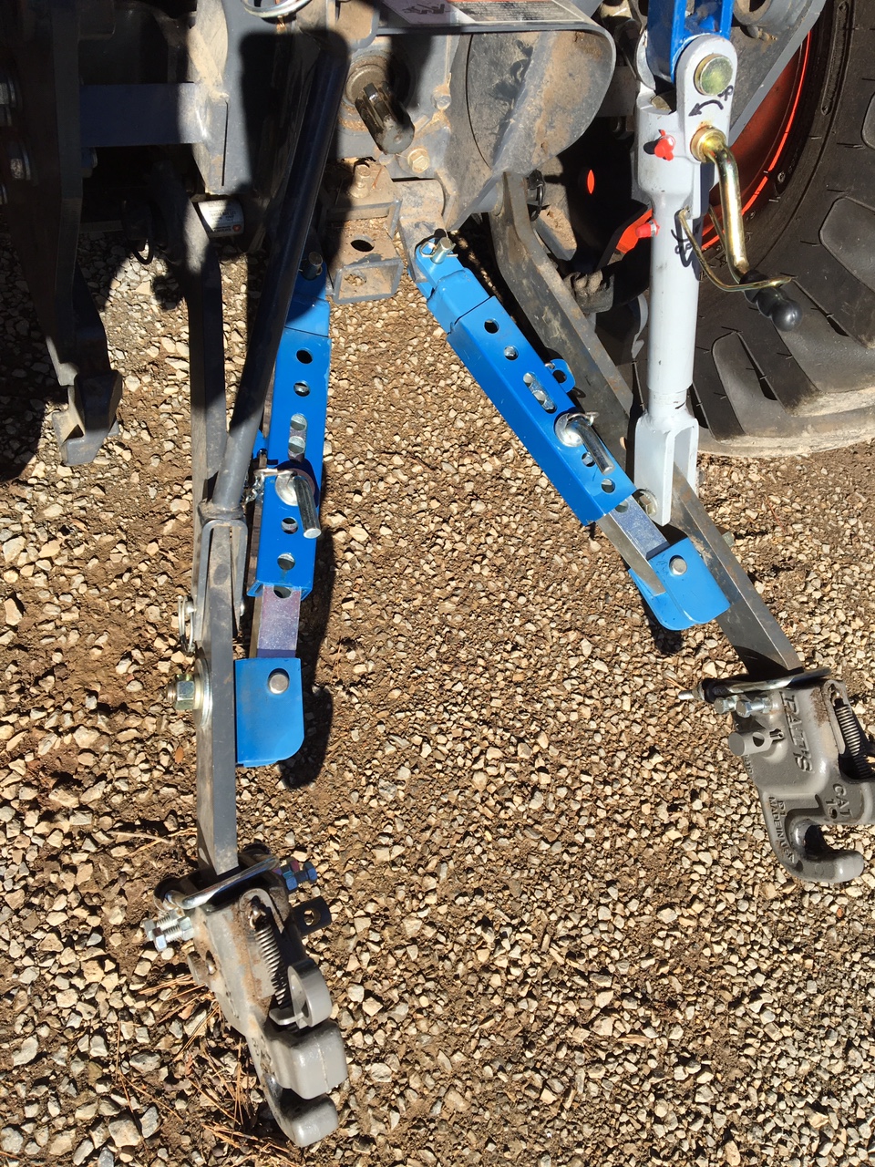

The one you would probably like, isn't made any more. Priefert discontinued pretty much ALL of their tractor stuff, and now only offer animal stuff - gates, chutes, fence panels, etc - the hitch they USED to offer is one I plan to "borrow" from for my 2 HF quick hitches
I have multiple welders and a small machine shop at home, but if you don't weld your only other option (if you wanted one bad enough) might be to buy the HF hitch, and take it (and this picture) to a weld/fab shop and get an estimate - You'd only need to change the toplink part, the other sliding parts were so it could be used on Cat1 or 2 tractors/implements.
BTW, for reference the Priefert used to sell for mid-$400 range... Steve

The one you would probably like, isn't made any more. Priefert....
That does look like a pretty versatile top-link connection! It seems like it might make up for my tractor's lack of multiple top-link pin holes. Thanks for the pic - if need be I may have to try to find a welder and show it to them. I'm yet hoping someone has a recommendation for one that needs no modification.

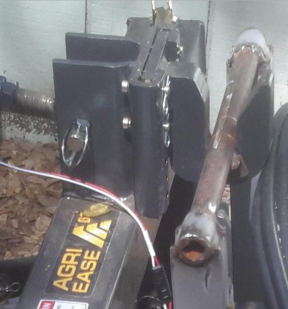

Buy any category QH that fits your equipment/implements( Cat 1-2-3) ... If fit is problem mod the equipment/implements (once) .... There is no perfect QH out there....
Personally I put a Agra-Ease Cat 1 on my SCUT because it did not have interference problem with upper hook bolts as most inexpensive Chinesium ones, save $20 on price for cheap Chinese QH and spend $30 for new longer extension hook... Where is savings.....
