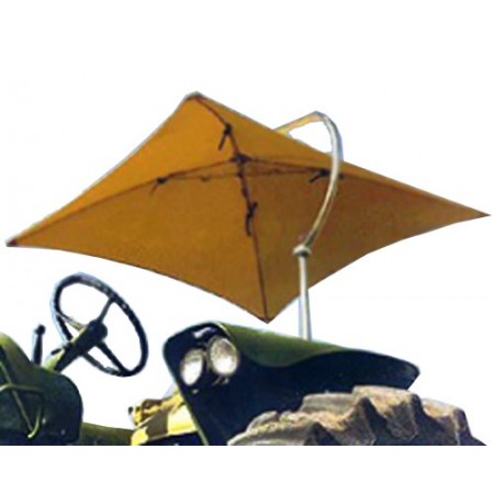

Like RScotty, I've got a canvas umbrella for my open station tractor. It's great for open field work and easy to remove for working near the trees and branches. Don't get the buggy style, it's harder to remove.
Here's what I got. Pull one pin and it comes off
Ru5 Rops Umbrella Rollover Bar
   / Opinions requested on 2 used options #10
Here's what mine looks like. Universal mount and a ball joint. Easy to mount and dismount. Surprisingly durable and well built for about $120.
rScotty
