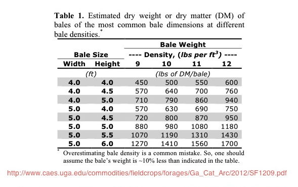

Hey everyone I'm looking for some opinions on what size gear I need for the hay I'm wanting to haul. I currently have a 20ft bed on a 8 ton gear. I'm only hauling about 8 ( 5.5ft x 4ft ) rolls of hay on it. I've just purchased a loader for my tractor and am now able to stack hay. I would like to haul 14 rolls this size at a time. Any sugestions on what size gear I would need to do this?
   / Opinions on wagon gear. #2
Maybe this will help.
Bruce
Table from article at:
http://www.caes.uga.edu/commodities/fieldcrops/forages/Ga_Cat_Arc/2012/SF1209.pdf
