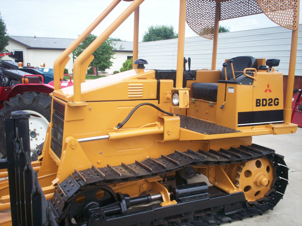

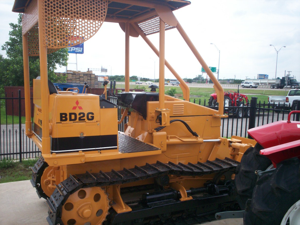

This thread might get more response if it was in the construction equipment forum, But I guess being an off brand unit it might not qualify.
I sure wish I knew someone who actually owned one. I, too, have looked, searched, wished I had one. If they would hold up, looks like a no brainer. You could use for mowing slopes, pushing brush, digging, etc. I just can't pull the trigger to get one. Not with out a lot more info. I thought it interesting that it had teeth on the idler sprocket on the front, most are just smooth with a raised area in the center. I looked at one (has Mitsubishi emblem on side) at dealer in Dallas, but didn't ask price, and from what I've been told, he's not a very reputable guy. Also, doesn't look like a lot of bolts holding track pads/grousers on (on the Nortrac unit). On the one in my pic, it had tag on side that give part # for filters from Komatsu, don't know what other parts would interchange.
Thanks for the pics.
