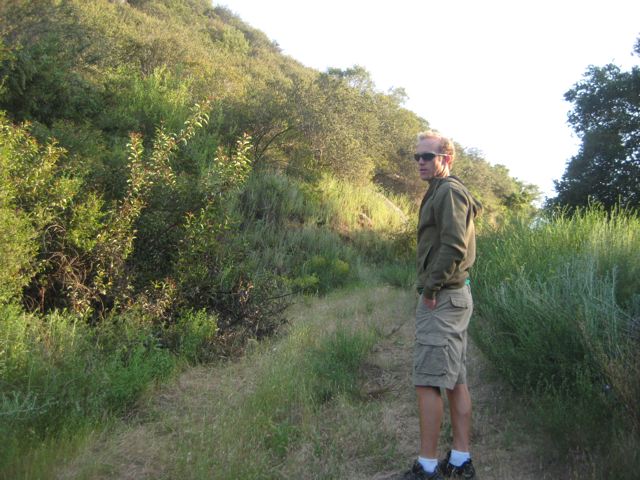

I've got about 10 acres of chaparral brush that I want to clear. It's pretty heavy brush with some of the larger bushes at 2" diameter. It's probably 5-6 ft tall at most.
I'm trying to figure out what I can do to clear this material. I've got a Kubota L4300 (45 hp) and was looking at fitting a gearmore flail mower on the rear. Some of the larger models with the hammerhead (GCF series) are supposed to be able to cut this larger material. Has anyone had experience with this mower? I've got a lot of steep land where I'll have to do hand clearing, but I'd still need to mulch this stuff up.
Also, there is a good bit of fairly flat land where I was hoping I could just back (or go forward) the mower straight over this stuff.
Any ideas?

Thanks for the info! I've walked the property with brush clearing guys and they tell me that, due to it's steep terrain, it will have to be cleared largely by hand. EEK! This is typical with this area though, and I had to have it done on another property. Some of the grades are over 35%...and rocky.
I'm thinking that instead of paying someone else to hire labor and manually cut this material and haul it to a road to be shreadded, I may as well buy the shreader myself and save the $$. I've looked into a few models and it looks like this Gearmore will do the trick.
I will look into trying to find someone with the feller buncher arm, but I'm doubtful that they would be able to do much with this land due to the slope...
