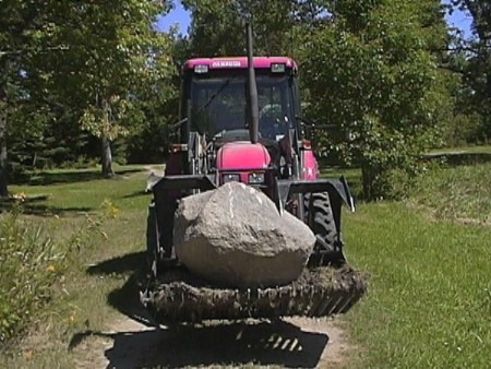

I run an AC615 TLB 60hp. I agree nothing is as rigid as an industrial, however my Zetor loader has pushed 12Klb rocks with no damage. Allis would not budge it, even the backhoe
