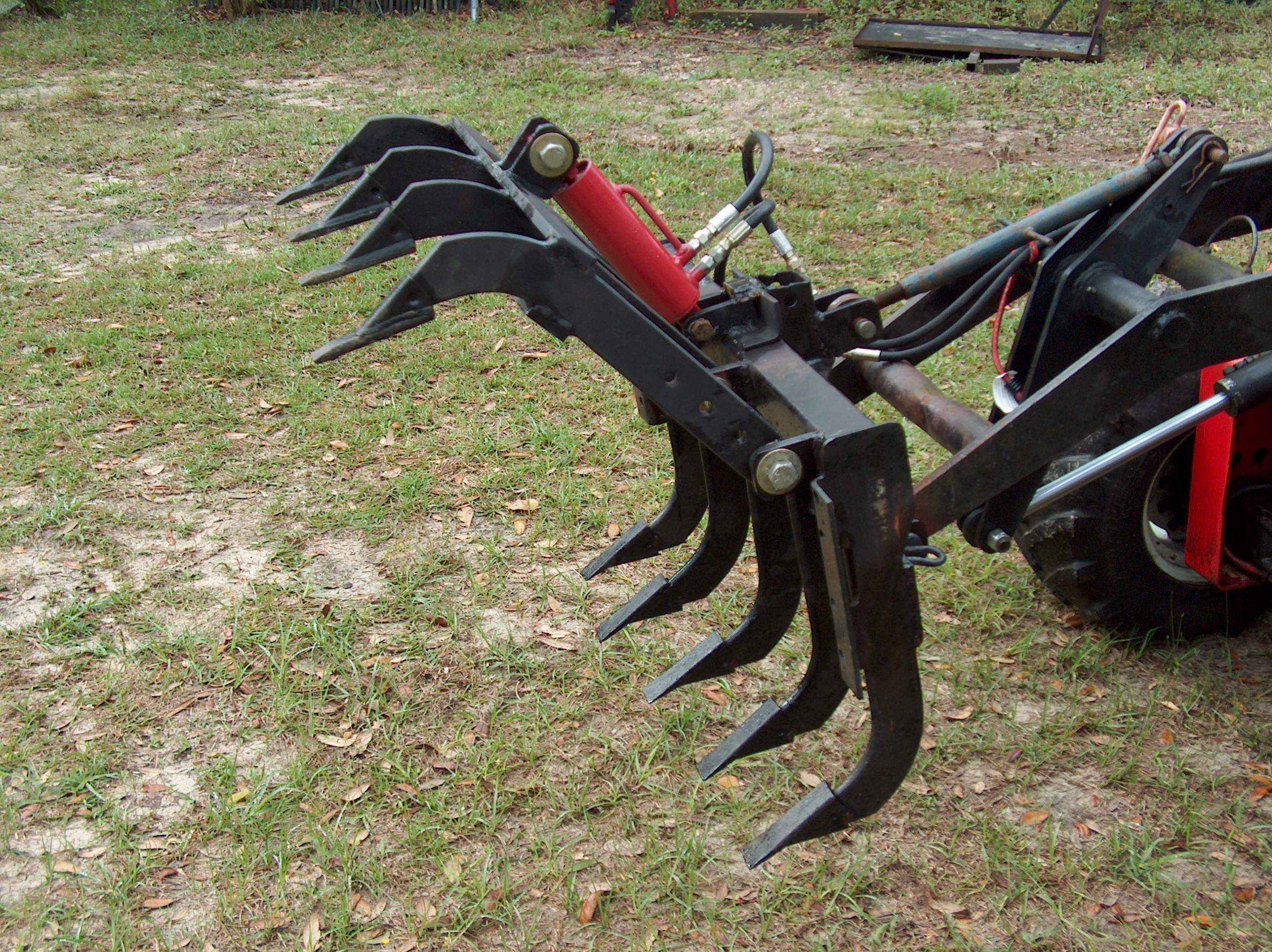

just using this as an example (see attch) what I mean by the "bars" is the two main pieces that actually grab something..
Looking at the device it looks like the teeth would be effective which I'm sure they are...but...my observation (by deduction only) is that they are just not needed...whatever they are helping to hold can't go anywhere anyway...
   / Opinions on FEL grapple bars #6
OK, now I get it...
You may be correct for a "thumb" style grapple like you pictured, but on my regular grapple I think they are useful for picking things up.
To save from "cutting" teeth, you could just use your welder to add them-a little pile of metal every inch or so may give it some "bite" if you need it.

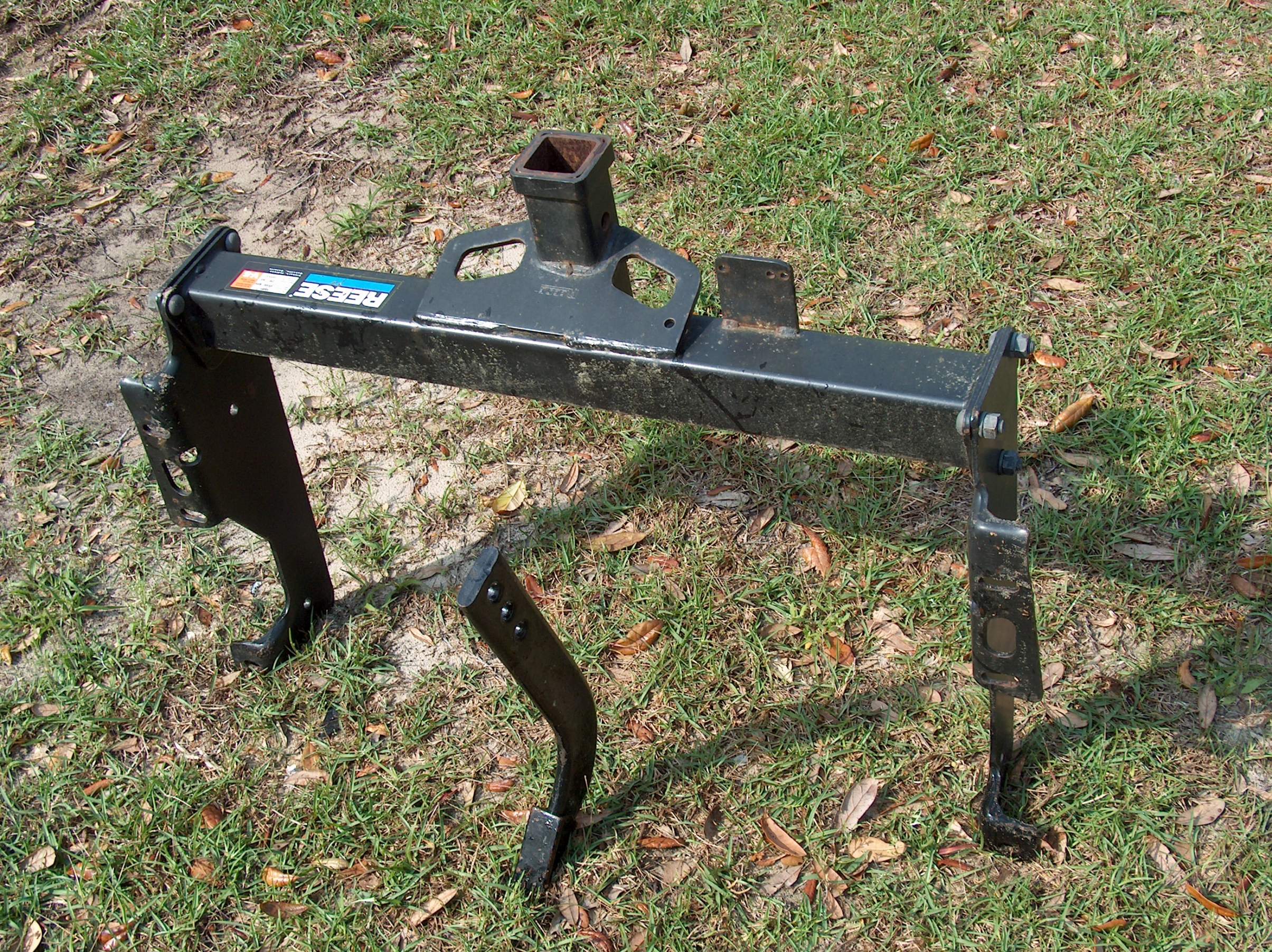

Here is a small grapple I made up out of box blade shanks, and some welding. Frame for the shanks is a hitch assembly

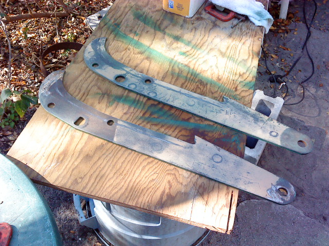

OK guys thanks...
I can bolt or weld teeth on in the future if required...maybe even some bolt on specialty teeth etc..
By trade (75% retired) I'm a shipwright/fabricator...I have a lot of tools but have just not done that much work with iron...
I have mig and stick welders and propane/oxy rig...
I tried with no joy to find a band saw bade that would cut 1/4 steel but never did find the right tooth stock...I ended up cutting out my grapple bars with a Sawzall...
Below is a pic of the bars...the bars are about 5/8" wider than I had planned because I originally was going to cut teeth into the bars...
Now that's a grapple!
