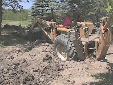

Here is my older Allis Chalmers 615, vintage 1970. Has 60HP diesel and is a 14' class backhoe. Weighs about 7500 and my 1 ton barely knows it's back there. It needs a 25' trailer to put the buckets down for traveling.
Pix is where it slid into a water line trench I was backfilling took a pix before crabbing it out.
