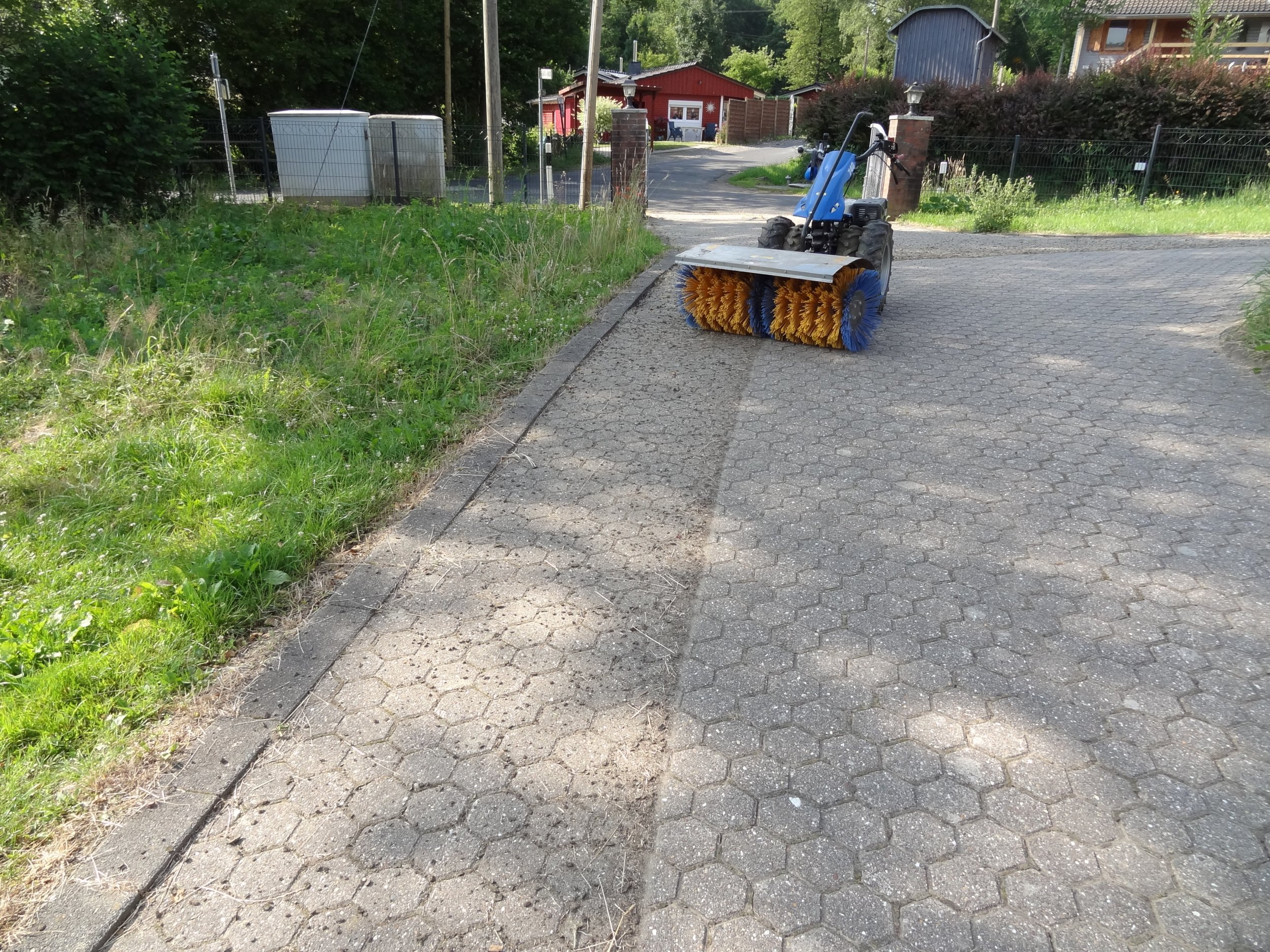

The left photo above shows part of my driveway, just before the sweeper has finished the job. Sweeping my driveway in the summer usually takes about 35-40 minutes, with the tractor in 1st gear and using half the working width. Driving this slowly and with this much overlap, gives a very nice finish, and also removes quite a lot of weed and moss between the concrete pavers, as the joints between the pavers are swept twice - and in opposite directions. When sweeping in the summer, I remove the two caster wheels supporting the sweeper. This way the brushes work the joints a bit harder, as all the weight of the implement rests on them. Secondly the sweeper follows the contours of my driveway better, and leaves no patches unswept.

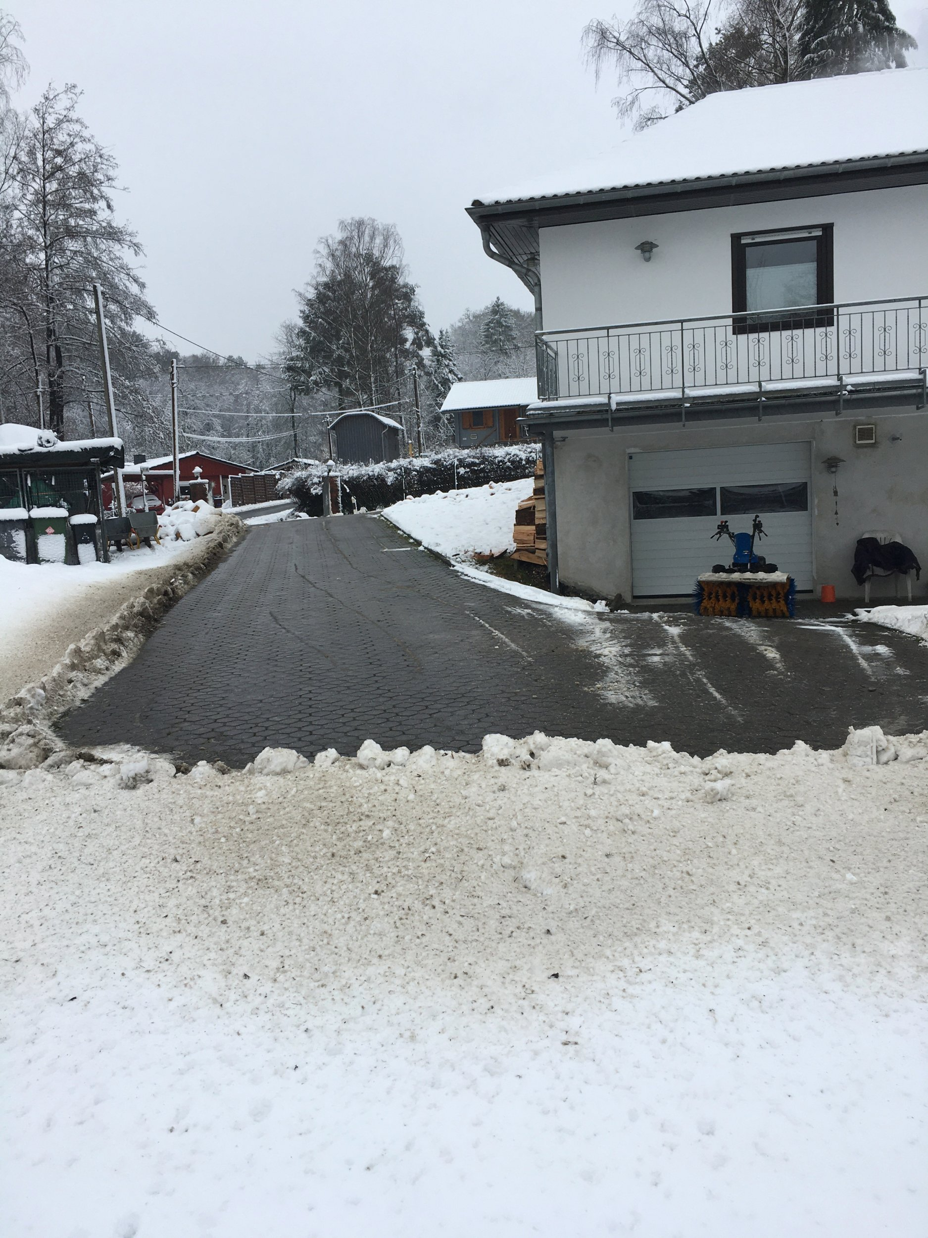

The right photo also shows part of my driveway, but this time in winter and with the job completely finished. The sweeper works well in snow up to 10 cm (4’’), and can handle up to around 15 cm (6’’). I have found, that when sweeping snow, a part of the snow is carried over the broom, and ends up behind the sweeper - the deeper the snow, the more so. As I saw a lot of snow accumulate on the inner side of the front rubber lip, I decided to remove it. This helped quite a lot, and I haven’t used it ever since. Depending on the amount of snow, I use 30-45 minutes to clean my driveway.

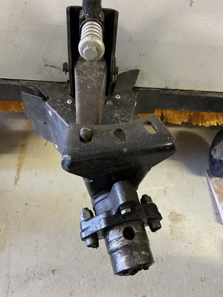

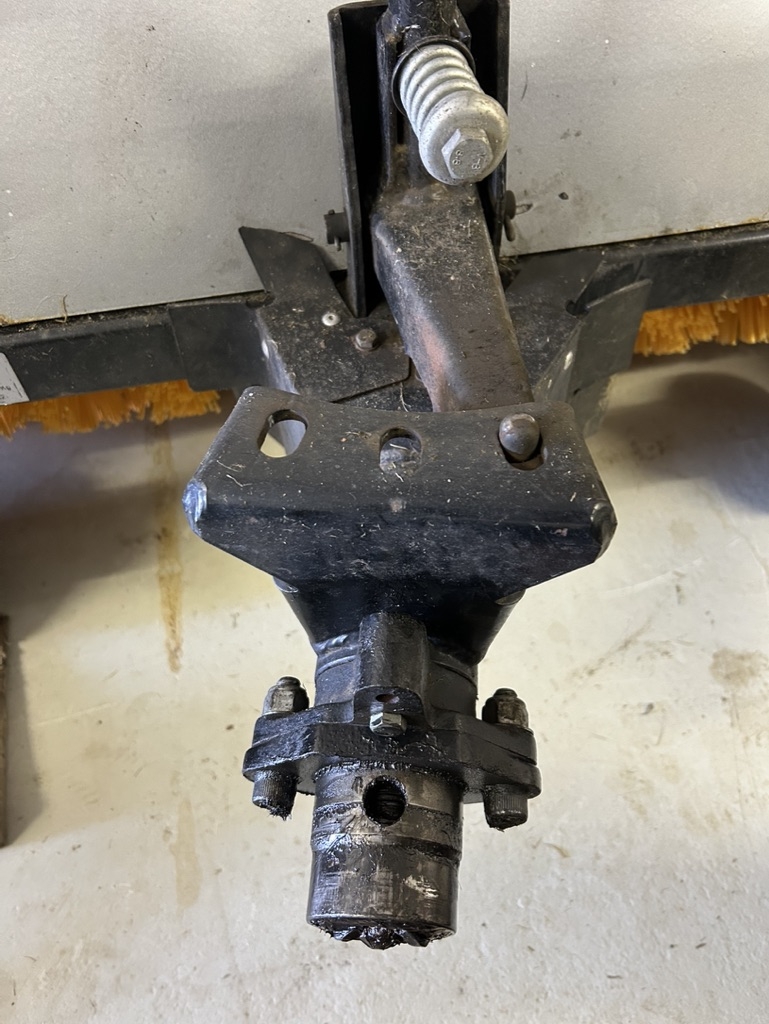

Compared to the sweeper from Caravaggi, the one from BCS is basically build as one „solid“ unit, and does therefore not have as many moving parts as the Caravaggi. To change direction the sweeper will pivot as shown below:
I took the photos in my garage where all my implements are parked when not in use. On the left photo the sweeper is turned to the left, and on the right photo it is turned to the right. When connected to the tractor, the entire sweeper of course will move, and the coupling stay fixed in the straight ahead position.

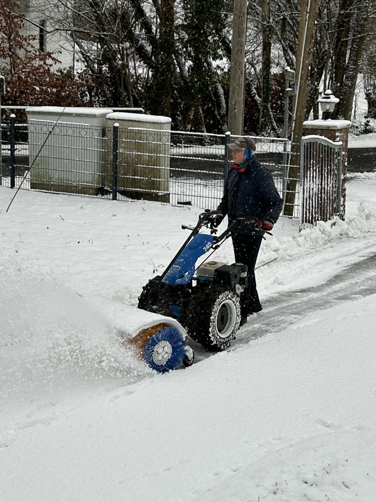

I have no experience sweeping on grass, but I sweep at an angle almost all the time, and with no problems at all. My wife took this photo a few weeks ago, when I was sweeping 2-3’’ of snow in our driveway. Here the sweeper is angled to the right:
As the sweeper rotates in the opposite direction of the tractor wheels when driving forward, the sweeper will exert a backward pressure on the tractor when working. If the tractor has enough grip, this is hardly felt at all, as the tractor will easily push the sweeper forward anyway. When sweeping at an angle though, the sweeper will exert a backward pressure in the opposite direction in witch it is turned. This can clearly be felt at the handlebar, and must be counteracted by the operator. Depending on the amount of snow, and how close to the ground the sweeper is working, one need to put more or less sideway force on the handlebars to drive straight ahead.
The BCS power sweeper is a good implement I would say, but sweeping dead grass put quite a lot of stress on any sweeper I would think. Compared to my photos, you probably would need to adjust the sweeper to its highest setting, to avoid that it will dig in.
