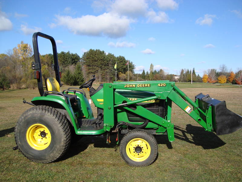

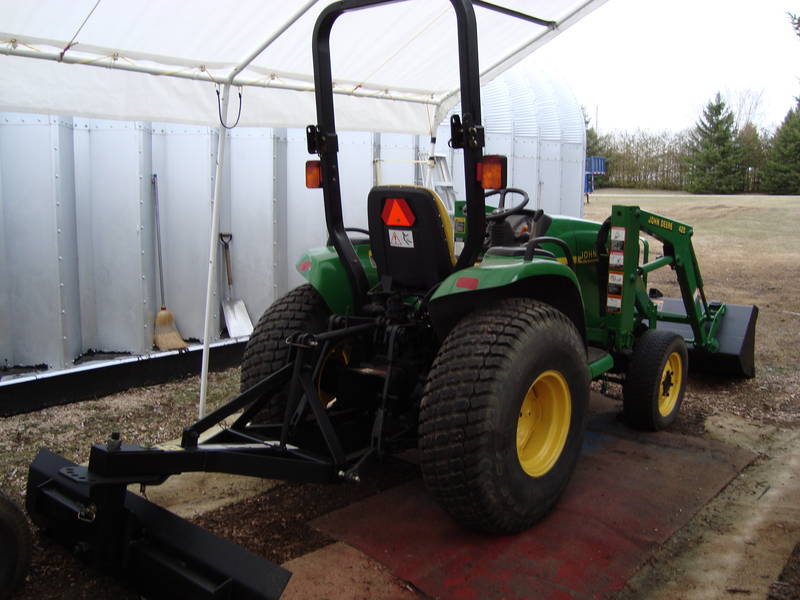

Have determined that I really need to have a loader as part of my arsenal for property maintenance, now that spring has arrived and now have been in the home for a number of months have a better idea of what I want to accomplish over time.
I have run across a John Deere 4200 for sale by owner,
"John Deere 4200 compact diesel 4x4 hydro with 420 loader and new rear blade and roll bar. 1250 hrs. 30 H.P." asking price is 12.5K
I have a 1968 diesel MF135 that I got last year with a snow blower but from all that I have read even if I can find a loader that I could put on it that is in good shape, I am a little reluctant to do so. Concerend that the tire spindles on the 135 are not really meant for the weight involved with a FEL. Added to that if I invest the money and cost to install an FEL on it (would want it setup right), may just end up having the old girl cost as much as this 4200. I do love the 135 but just not up to everything that I need to do it and don't want to pay services to come along each time I want to do something, think that translates to even more cash.
Have attached a photo of the snow blower that I have with the MF 135 which I do want to keep, have 300-400 feet of driveway to clear out and this thing is fantastic. Another thread someone thought that the JD 4200 would be able to run this, would everyone agree or no?? I don't really know the weight of it but its a pretty standard style of 6 or 7 foot snowblower. As you can guess, not thinking of keeping two tractors.
My other thought keeping things in one and not having multiple vehicles, I had thought in time that if the 4200 would be up to the task, selling off an LA145 that I have and getting the mower attachment for this since it has a mid-mount PTO. If it would run the snow blower, it has a loader and ability to cut grass, would have everything in one package or am I crazy to think this??

The only thing I've ever herd or read bad about the 4200 is that it lacks power for the size of the tractor.
There are a few TBNers, Egon (fellow Canadian) and arribal (guy is local to me) who own them. I cannot speak for Egon, but arribal did mention his tractor was a bit weak (he was comparing it to my 4400 Deere which has a reverser transmission).
I'd send a private message to Egon, if I were you...
I really don't think the 4200 will handle that big snowblower...6' would be pushing the 22 or 23 PTO HP of the 4200...7' probably wouldn't work at all.
This only other thing I'll add is, if you're really interested in the 4200...don't hesitate too long. Good used tractors sell very quickly.

The front snow blower used for the 4200 is 59" wide...almost a foot narrower then the 6' unit.
The 4200 weighs in about 2900 lbs for the base tractor.
I doubt you find a smaller tractor that could handle that blower.
BTW, the 4100 is a considerably smaller tractor. That's probably a 60" blower on his 3PH.

Egon has a JD 4200 and likes it very much. It was a step up from a Kubota B7100. [the Kubota was an absolute MULE and preformed well beyond it's design]
The 4200 seems like a physically large tractor but only has 26 HP engine. For me it works well for moving dirt and snow. The #7 backhoe works just fine and could almost be rated as a small real backhoe.
Due to circumstances beyond my control I've used the tractor very little so my opinions should be factored in as very little.
Don't think it would have suitable PTO HP. for the snowblower shown.
My only complaint is a well though out ignition key location that seems to hit one's knee and break off. :( Kudo's to the designer. Otherwise there are no complaints.:thumbsup:

I have had my 4200 for about 12 years now. I have the front loader, backhoe, brushhog, post hole auger, stone rake, 3 pt. wood splitter, round hay bale spike. It has preformed well past my expectations. I will say that I have misused it by overworking it with the hoe and loader. I have 1200 or so hrs. on it and have only done routine maintance. I really like it.
Egon, Yes I had the same problem with the key getting broken off. After about the fourth time, I had a new one made and ground down the head of it so it is just large enough to get a hold of to turn it and haven't had the problem since.
