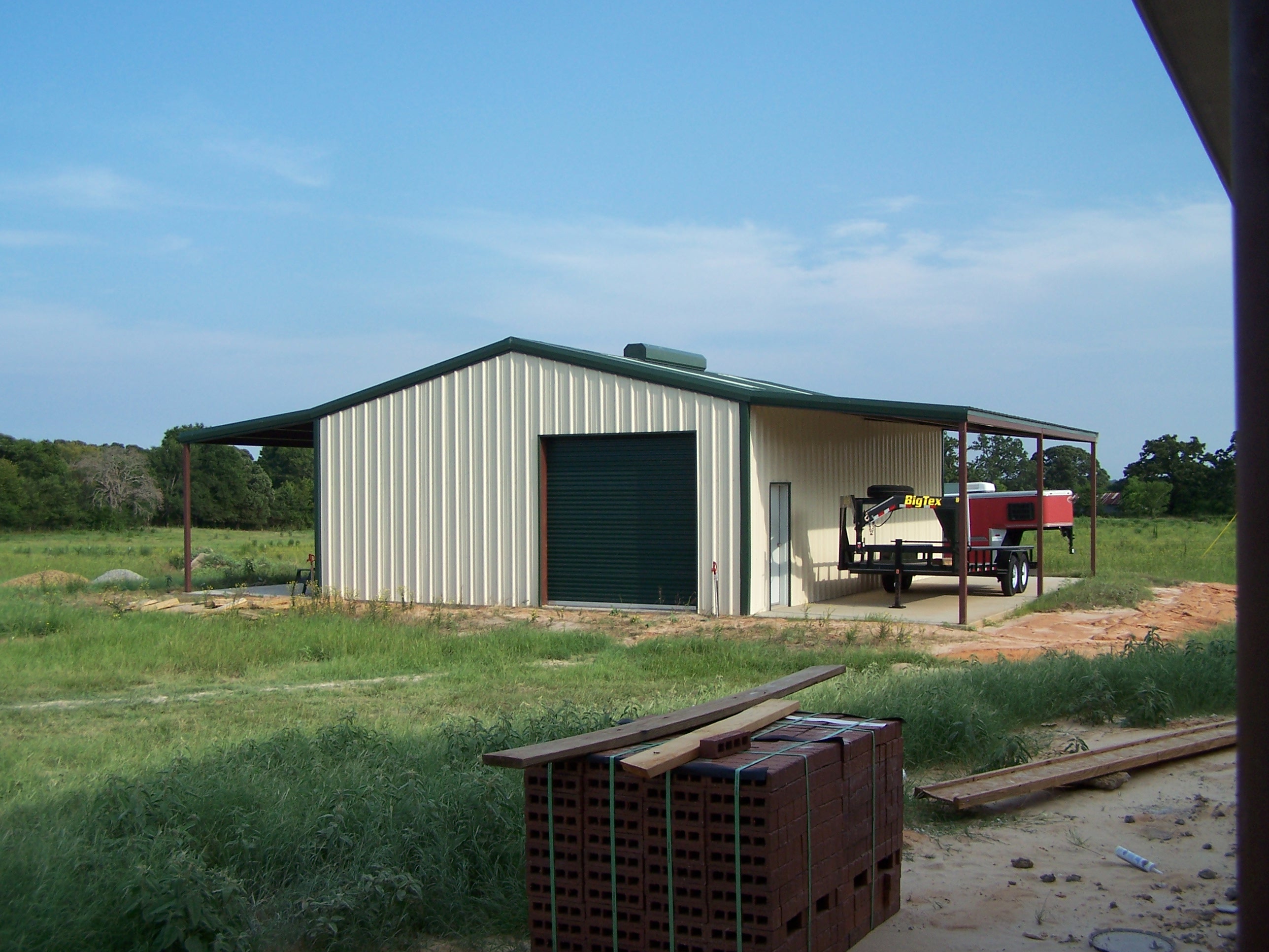

I insulated mine in East Texas and put in a pop up roof vent. It does help keep it cooler when closed up in the summer. Skylights are also a good investment.
