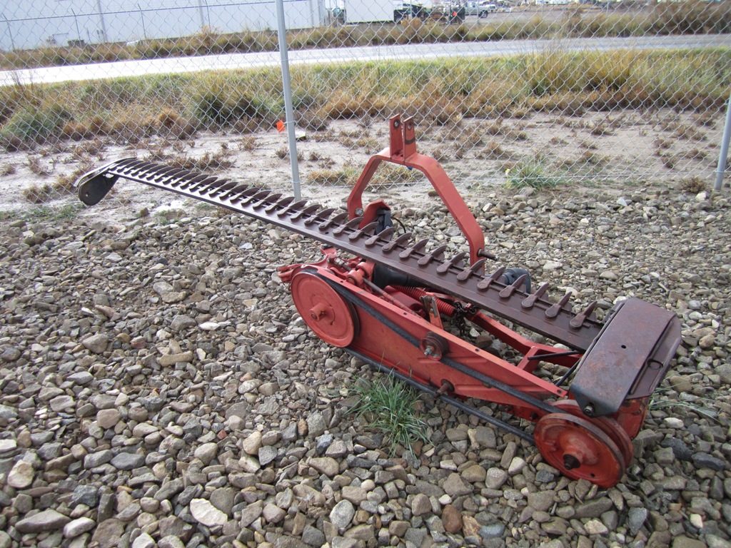

I found what appears to be a good used 9 foot IH 1300 sickle mower. I think it is overpriced as it is missing the end grass guard assembly and rear safety shield for the drive belt. They are asking $1750 It appears to be a mid model production with a serial number 312XX series. Grass guards are still available from several sources ($250 to $300 complete)
I have only looked at photos so far and I may go look (Its 1.5 hours away). I know to check the teeth, belt and assembly for movement, but how do I check the PTO drive bearing and mower head? What sort of movement is acceptable? Where should I look for major wear or breaks?
If I find everything OK what is a fair price?

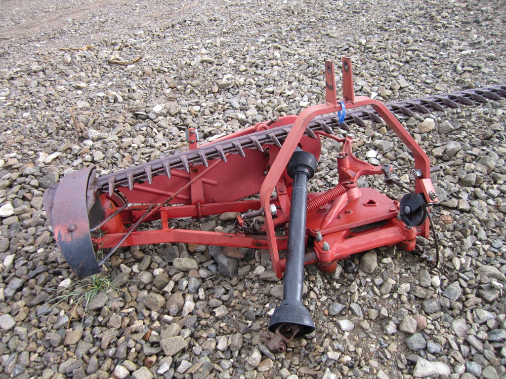

Well to make a long story short, its in the back of my pickup to unload. :D Mower has original paint. Every single guard and knife is in perfect condition. It is a 9 FT IH 1300 unit, not a Case /IH.
I worked the head, and while stiff (its was about 28 degrees and foggy) there is no play, even at the pin. In addition there is very little play at the wear plates. I have some work to due, especially adjusting the lift spring. Dang that 9 foot bar is heavy. I got them down to $1550, but given the original paint, tight head and excellent condition on the bar I decided to not pass it up. Probably paid top dollar, but I'm good.
Now to find a good operators manual, service manual if there is one, and parts book - any suggestions? Maybe Santa can find some for me :D
Ill unload tomorrow - this should be fun. :eek::eek::D:D
