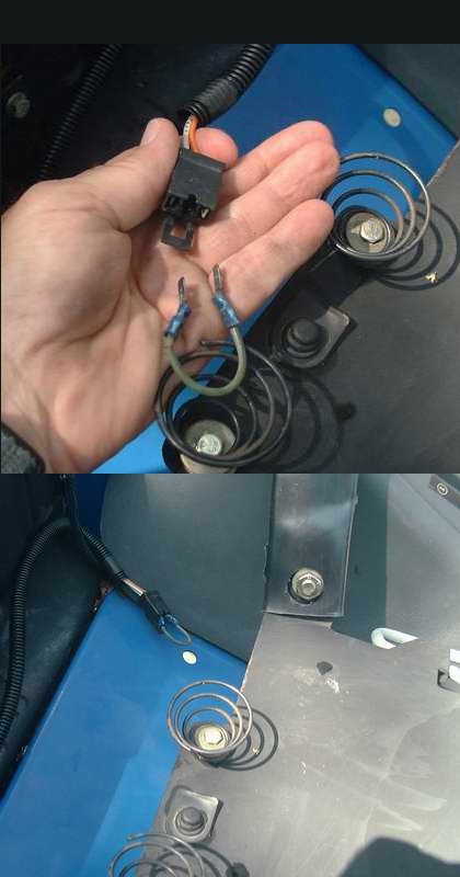

JT, I agree with TC35Dforme that you can easily bypass your switch and not worry with it. If you need help with the electrical connection, I'll draw you a picture...much simpler than welding. Now don't expect me to make any apologies to the "safety police" about bypassing this switch. I've operated too many tractors in my life that had no switch whatsoever and I don't feel one ounce less safe with the kill switch working. As a matter of fact, that's the first modification I made to my tractor. I also remove the reverse gear kill switch off all my riding lawnmowers. Can you imagine not being able to mow in reverse? Anyhow, I can't think that anyone who is responsible enough to own and use a tractor without running into walls really needs a kill switch on the seat. In your case, I'm sure a simple plug-in bypass will be much easier and more effective than the welding method. My guess is that you are a lot more comfortable welding than working with wiring, but there are plenty of us here who will make sure you know how to do this job if you want to do it.

Hoeman00, I think you did miss that JT had the problem noted above. In my opinion, your method is fine unless you are standing up and hit a bump large enough to make the seat bounce. When I get a chance, I'll take a picture of my bypass and post it.

Well, here is the photo I promised that shows how to bypass your seat switch with two inches of wire and two spade connectors.(see attachment) After bypassing the switch, I just looped my wire around the wire going up to the tail light and it has been there for 1-1/2 years with no trouble. Again, there are many ways to bypass this switch, but I don't know of any that are so simple to do as this jumper. /w3tcompact/icons/clever.gif
