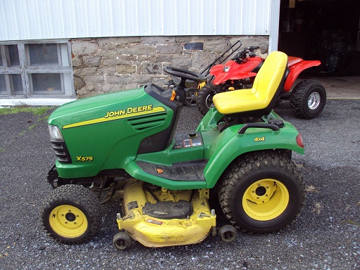

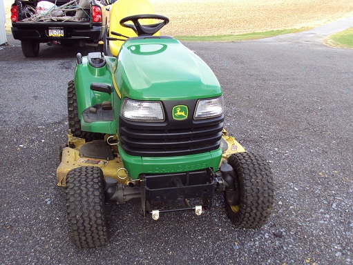

Thank you I am off to find a picture of the rear and here are a few picts. of the mower i am buying. It seems to be a pretty good deal. it is a 2006 x575 with 175 hrs, 54" deck and 54" blade. Was only looking for a nice rider when I fell into this

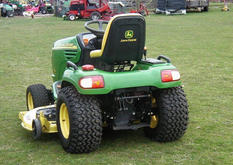

Here is the picture showing the rear end linkage I was talking about. If you look at the rod running paraelle with the axel you will see 2 arms the rod runs through. That is what I was speaking of.

That is the hyd cyl that lifts the deck. Not the 3 pt that is a Deere option (I think ? ).
That last pic looks like a dealers lot, and not a Deere dealer. The tractor looks in great condition, but I'd be sure to blow out the radiator fins from the front towards the back, with the drop-in screen removed. That will get the latent dust out and make it easier to keep clean. I wouldn't try to wash it out as it may turn to mud and just stay forever caked onto the fins of the radiator.

The price seems on the low side, so thinking you are getting a great tractor and think you will like the 54" deck a lot (I do mine). Lucky you. :)

that's a nice unit, and they are quite durable and reliable.

correct on those rods etc at the rear, connected to the
cylinder that lifts the mower deck. if a 3ph was to be added, those
items get changed around a bit to accomodate. there should be
a hydraulic oil shut off on the scv (on the backside of where your
blade hoses would connect) that you shut off for blade use, giving full
oil supply to the blade instead of operating that mower lift cylinder all
the time. (open back up for mower use)
