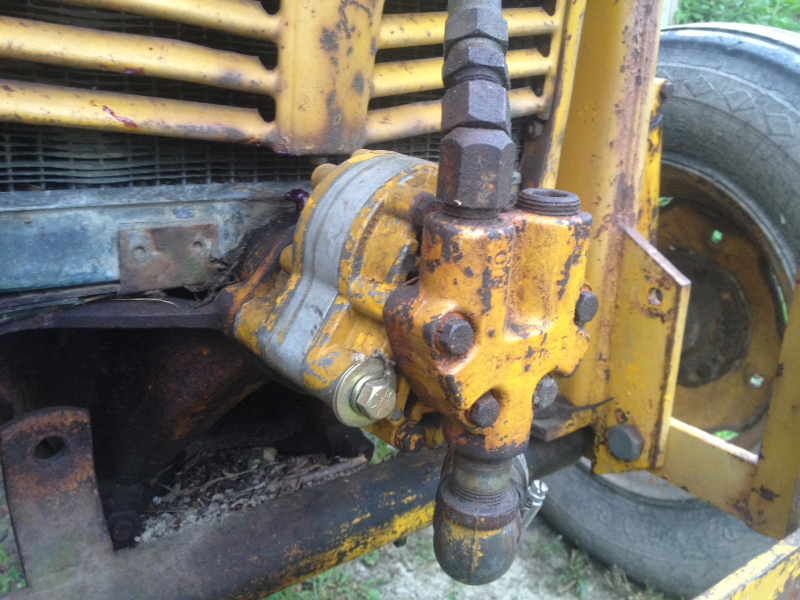

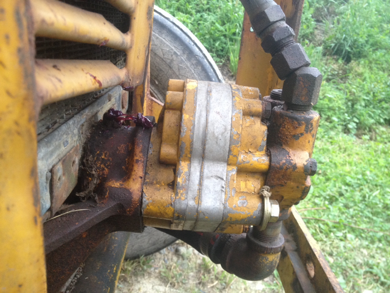

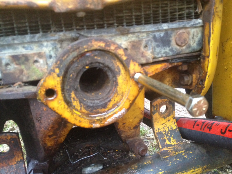

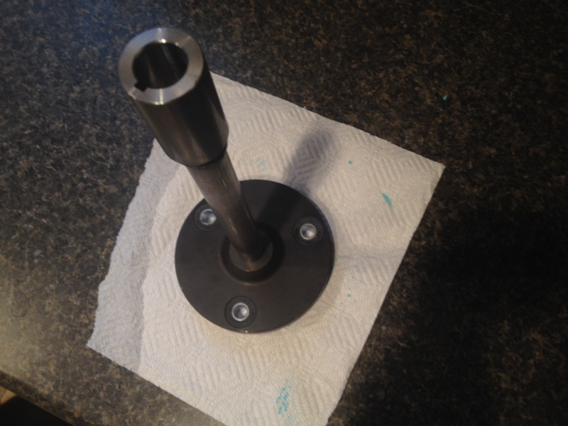

Here are a few pics of the mounting boss on the front of the MF 35 (mine is a 35 utility, hence the yellow paint but is very similar to your machine)
The adapter and shaft are connected to my crank pulley, which is designed to run a front pump. You'd need a new pulley (unless yours has three or four threaded holes for the adapter), an adapter, shaft, and pump. This is the best way to run a loaded off a MF35. The internal pump is only 4-4.5 gallons per minute, so it'll work, just slowly.
External pump operates much faster.
Now that's an idea I'd not considered at all, and might very well give the best results, so I'll look into that further, thank you for that!
