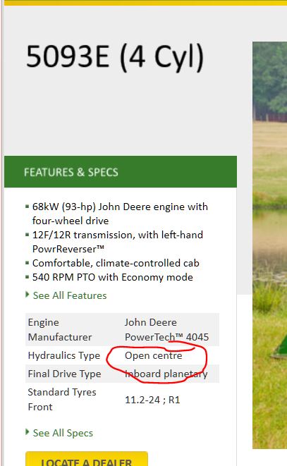

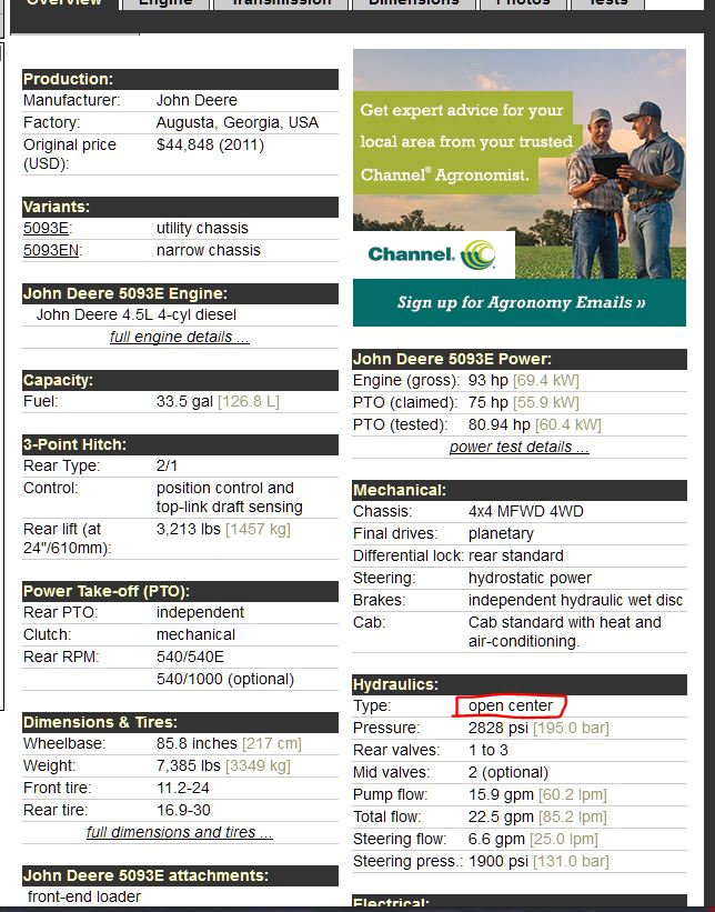

According to Tractordata.com your tractor is open center. Any time hyd oil gets much over 225 degrees there's a problem be it open or closed center. 180 degrees is fine.

TX Jim is correct. The JD parts catalog shows double gear pumps used on the 5093E models so it would be an open center system.

I think that must be a mistake

I don't think Deere would put a closed center hydraulic system on a E series tractor. What you may have is a open center hydraulic system with closed center remote valves.

My sentiments exactly. I wonder what else your dealers SM doesn't know about new JD tractors.
