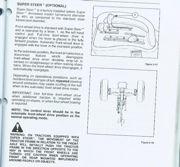

   / OOPS 4WD Down Road #9
That is one nice thing about Super-Steer and Sensi-Trak option on the New Holland units. I don't think I ever put mine in 4 wheel as it does is automatically.

Thanks Guys- I guess I won't worry too much about it then. I like the idea of a light or something, but am not sure where to start there. Mainly I have been moving dirt with FEL and blade so I need 4WD, but it is hard to remember to shut it off when I head down the road. NH's Sensi-Trac sounds nice but I'm pretty partial to green /forums/images/graemlins/smile.gif and also wonder if that is just something to go wrong? Jason
