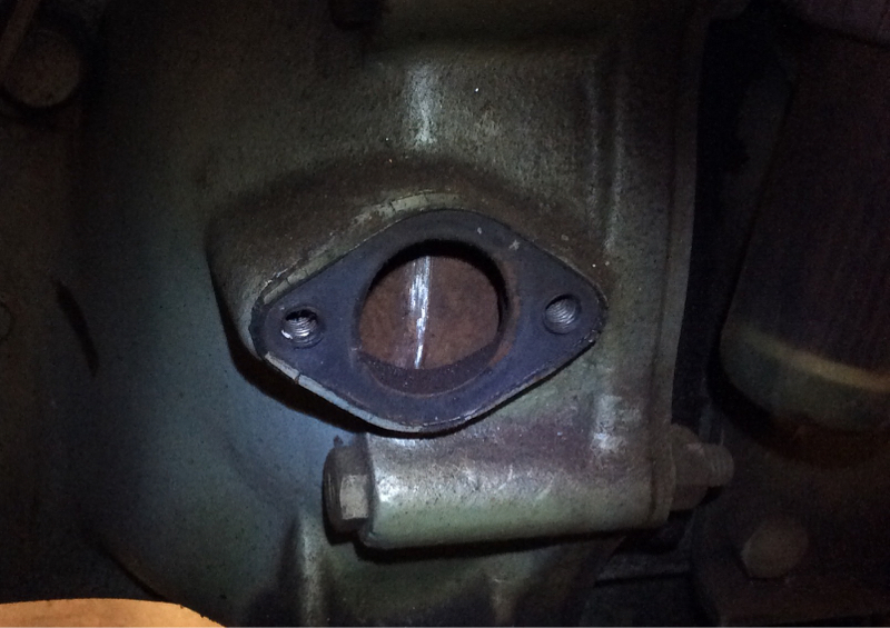

Thanks Winston. Is there anything to be learned from looking through the little access hole on the side of the transmission?
   / One too many snowstorms for the 1510 #4
Not sure where that access hole is located. Thinking maybe on the clutch housing. Also not sure what you can see there. If you can see the clutch shaft and is is turning then that would eliminate the clutch as a possible problem.
Sorry, "right side of the bell housing" would have been a better description. Engine is to the right in the picture. The horizontal bolt below the hole is attaching the bell housing to the engine and this is all on the opposite side of the tractor from the starter. If I look at an angle enough toward the engine inside the access hole, I can just see the tops of the flywheel teeth the starter engages with, so I assume I'm looking at whatever's attached to the flywheel, guessing it's the pressure plate (#20) in CLUTCH: Yanmar Tractor Parts. It spins when I turn the starter. I can't see anything looking toward the transmission side of the hole, or at least not well enough to have any idea what I'm looking at.

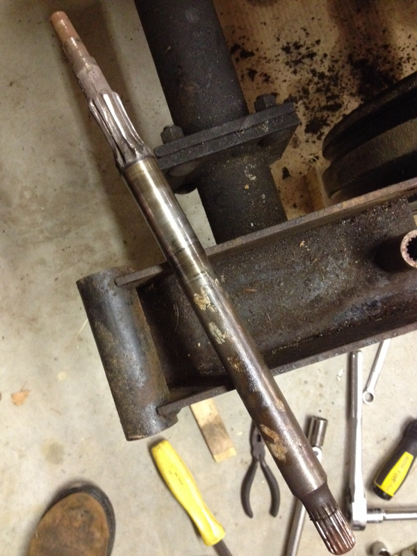

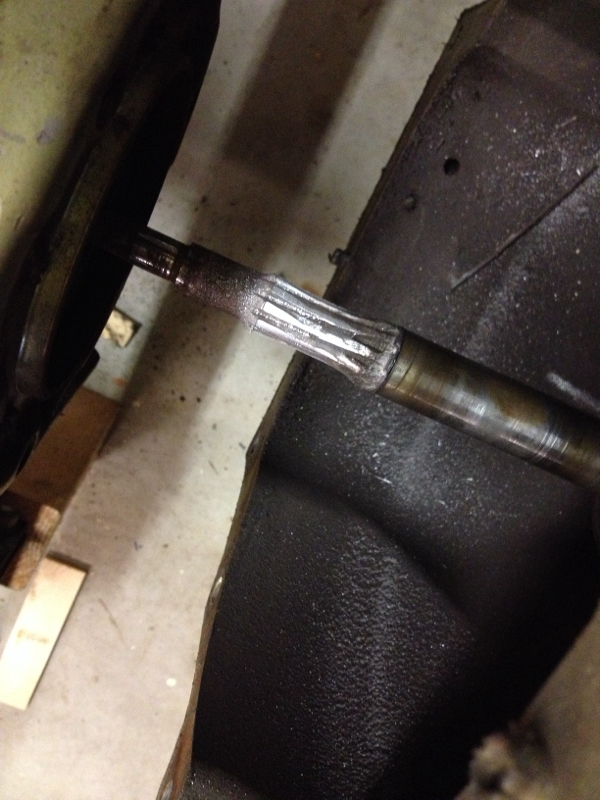

#9
Good call Winston, it does appear to be a now-spline less shaft. I'll see about taking the pressure plate off tomorrow.
