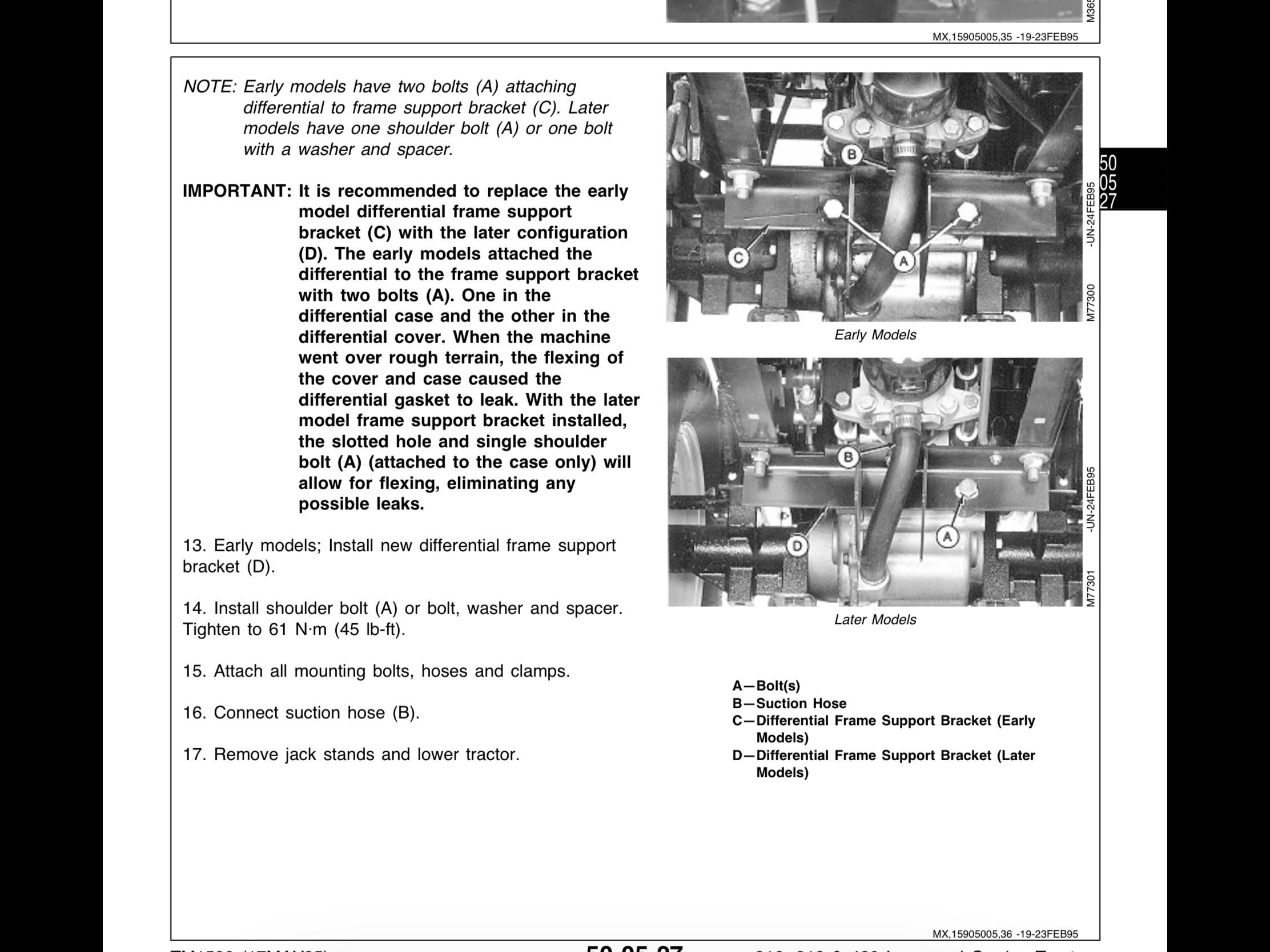

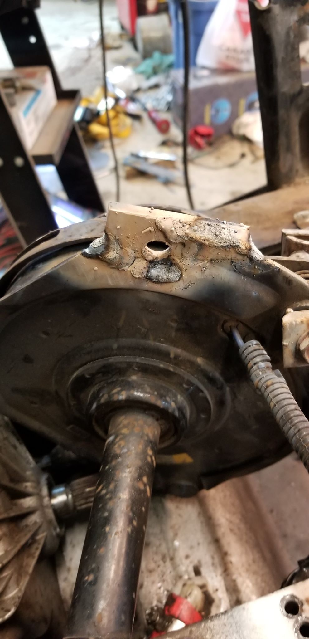

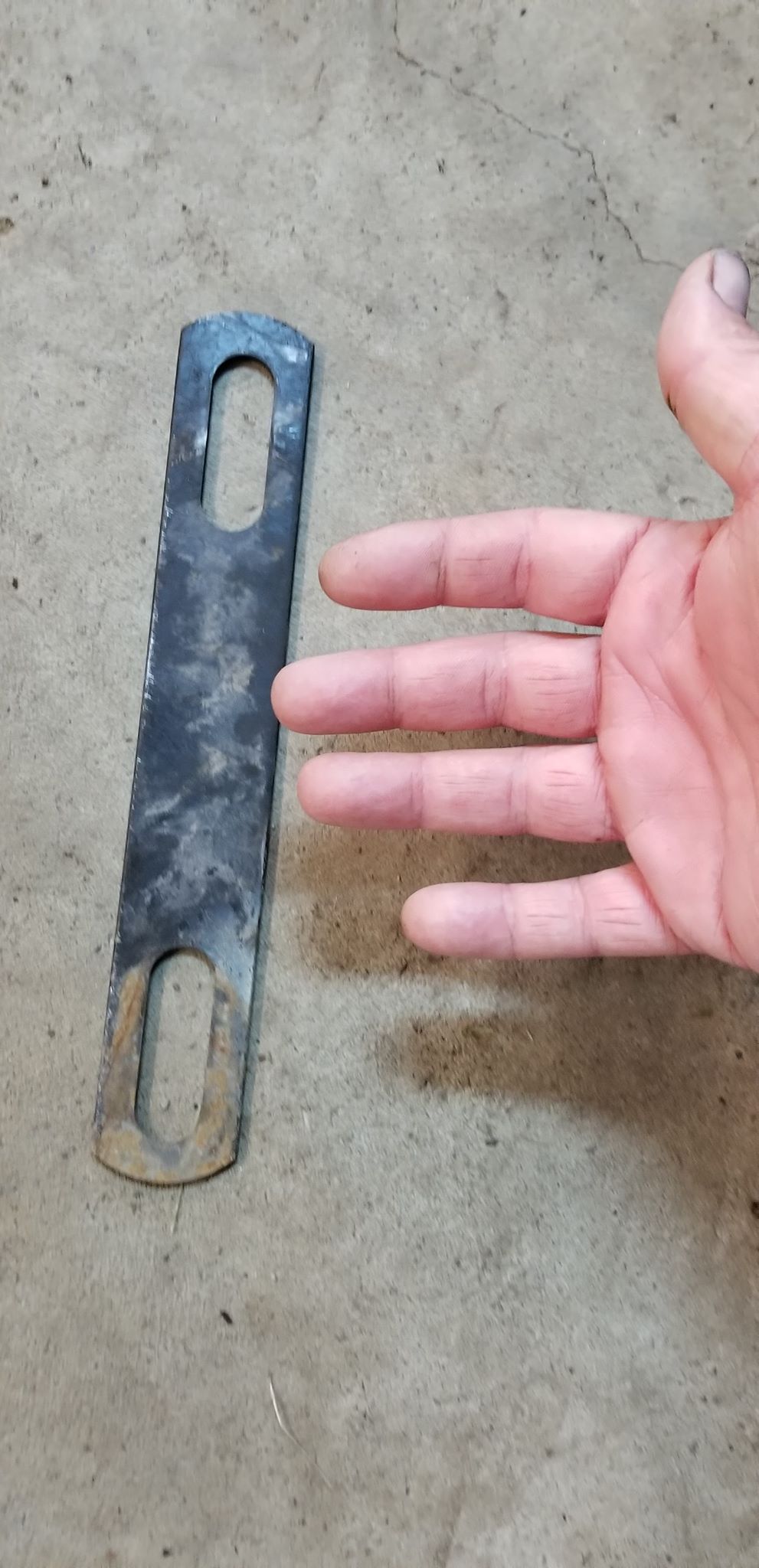

Picked up a project last week. Lower mount for transmission that attaches to crossmember broke off the housing. Tore tractor down, got it welded up, repaired a few items and just about done reassembly. john deere 420 linkage.jpgjohn deere 420 3pt hitch.png
Hoping someone can help me out and solve this mystery.john deere 420 pto clutch weld.jpgjohn deere 420 transmission repair.jpg

To Add, i also have a john deere 318 with 3pt hitch and it does not have this bar.

Here is some info on the crossmember.

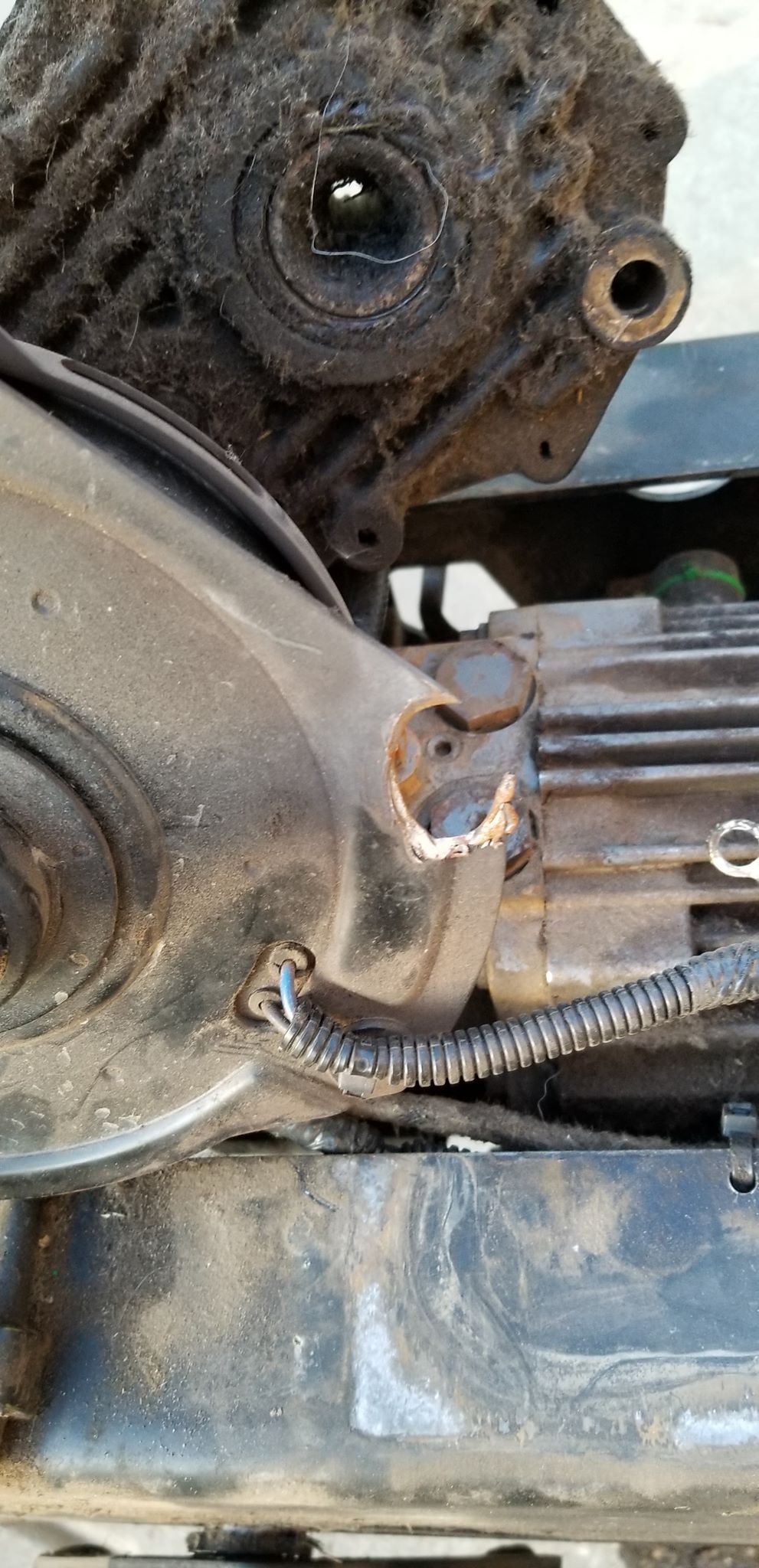

Thanks for the info guys. Will modify the crossmember. It's been a fun little project. John deere 420 PTO clutch hole.jpg
Quick little job repairing that. Turned out okjohn deere 420 pto clutch weld.jpg
