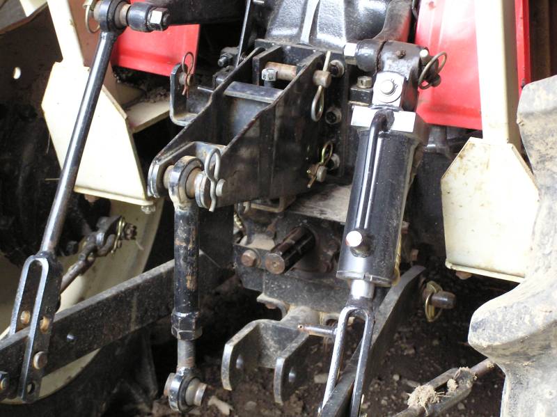

I'm trying to find a picture of a 2610 hooked to a tiller, I'm 99.9% sure I have the bracket on right, but it will go on two different ways, if you have a pic or know of a web site, I would appreciate you posting the pic or the link.HGM setup is close, but mine is a little different, but thanks for your pics, on the other post. Just to let you guys know, even if its hooked up wrong, had to try it out, sounded great, no noise and set it on the ground for about a second or two, but it didn't like Alabama red packed clay, but it was going to till it any way, can't wait to get it in cut ground, and my sons also like the idea of not using the front tine this year, and having a lot bigger garden. Thanks for the help here and on the other post. Robert

I can't help you with a 2610 tractor but here is a pic of the upper attachment point on my F series.
Note the vert bolt by the upper hitch pin. With the bolt adj'd it serves as an alignment stop so the lower hitch pin just pushes through.
Hope the pic is helpful.
