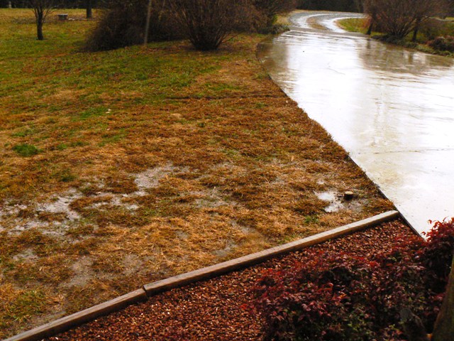

However, I've noticed another issue (now that I'm looking for them) with water from the driveway.
Have a cement driveway in front of the house. House sits on a slope, as well as the driveway (very slight leaning towards the lawn which is on a slope as well). The water from the drieway is coming onto the lawn, causing some erosion in the area just below where the driveway ends (on the slope).
You can see fromt he second pic the worst part of the area in question is about 5' up from where the lumber ends to the drivway. You can see the water "sitting" on the lawn. This is the "problem" area.

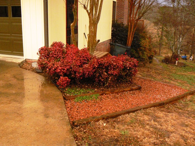

I added a side door to the garage last spring (seen in the first pic behind the tree on the right corner of the house). Since I have a large deck out back of the house, wanted to keep this simple.
Eddie, in retrospect, you were right the first time as far as wanting to get "creative" with a deck. I ended up just putting in simple steps for us and the dogs since we use this door about 90% of the time to get into the house. Issue became that with rains and constant use with us and the dogs, even harder erosion sp? with the ground at the base of the steps.
Thus, I laid down some timber and put in gravel going up to the cement driveway from the base of the steps to ease the wear and tear of coming in and out of the house.
Now what I'm thinking of doing is rip the trees and brush out from the corner of the house (per the pic) and put in a deck that leads out from the side garage door directly to the right, out to the drieway (figure about coming out at leat 10' from the house, and about 15' wide). This deck will only have one entrance, that being to the cement on the driveway. This will force the dogs to go out onto the drieway from the enlcosed deck. I'm hoping this will ease the "wear and tear" from the dogs going in and out on a regular basis on to the lawn, particulary in heavy rains. Bottom line,, the deck would end up covering all the area were the tree and brushes are, as well as the area where I laid the landscaping timbers as well as gravel.
Before I do this of course, I will dig for the piping under the deck for drainage. Thinking of using hard PVC (for drainage) just for under the deck because once I lay the pipe under the deck, I won't have access to it.
Needless to say, the lumber I laid down to contain the gravel will be coming out (for laying the underground pipe for starters).
Now, since I'm planning on doing all of this, I would like to take care of the issue with the water running off the drivway onto the lawn.
My first thought was to dig a deep trench along the drivway and fill it with gravel. I'm thinking this may not work if we get a heavy rain because the trench will just fill up and I'd still have "overflow" issues. I also don't want to just end up leaving a "path of least resistance" directly to the house for the water from the driveway.
Is there anyway to lay pipe down on the side of the driveway to catch the rainfall? I was thinking of some way to divert that water (from the drieway) to the pipe I'll be burrying in the springtime on the right side of the house (from the pic).
