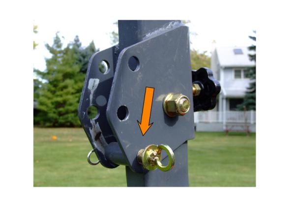

I had a tendency to lose the 'spring' on the 'pin' that folds the ROPS.
I used a hot glue gun and laid a circle of hot glue at the base of the pin, then slid the spring back on the pin, pushed it firmly into the glue.
I have not lost a spring since. /forums/images/graemlins/smile.gif

So I'm not the only one that loses those things. /forums/images/graemlins/frown.gif

I just lose the whole bloody pin, clip, and spring. I came in one day and only had one of them. Turns out a standard hitch pin works.

I haven't lost one yet but I will. Good idea. .................or why didn't they just use a shorter pin?

The spring is there so the pin won't rattle as much. The 3054's are almost deafening at idle LOL.

I couldn't remember which side to put the spring on so I leave mine out. No rattles, maybe since I tighten the set bolt pretty hard.
