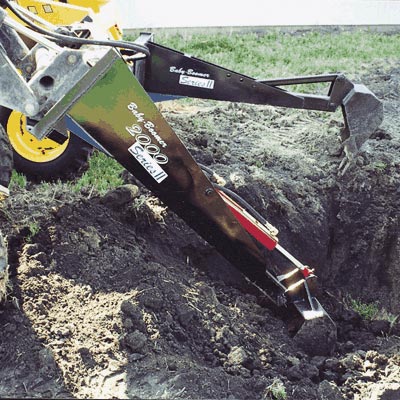

Depending on how the bucket is designed, it dosn't really require any additional re-enforcement. The top of the bucket I have is made from a piece of box tube. This distributes the forces from the center cylinder across the width of the bucket. There is typically a cross tube beteen the loader arms somewhere up from the bucket. That is where the center cylinder would need to run from anyway so again no real additional structure required, just perhaps a heavier walled component is used. The 3rd cylinder will require an additional attachment point on the bucket. In the case of mine it is two pieces of angle welded vertically on the back of the bucket with a 1" pin hole between the pieces. The attachpoint for the cylinder on the bucket is down in the middle of the back though so the vertical pieces of angle tie the top cross box tube to the bottom plate of the bucket to resist bending. On the dual cylinder buckets, all they need is an additional set of holes on the end brackets for the cylinders to attach to. In my mind this would not be as big of an advantage in fabrication as compared to not having to procure, fit and finish the additional plumbing, hose, fittings and cylinder that a 4 cylinder loader uses.
A single dump cylinder also lends itself easilly to other projects such as a trencher arm(mini back hoe on the front) like the picture I have attached. I have cooked up a design in the CAD program that I may build this summer and a center cylinder is perfect for making this a fairly simple addon project that dosn't require a whole backplate structure.
Good luck with your project and show us some pics as it is going together /forums/images/graemlins/grin.gif.
