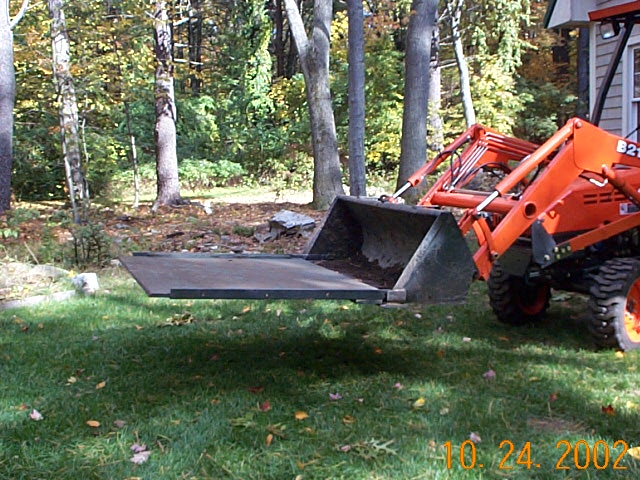

Here are several shots of the big scoop I made thanks to Harv's post One Large Scoop Please, and other comments and feedback from that post.
Essentially this is 2" angle iron with 3/4" plywood base. The 1/2" pins with quick clips go through the angle iron and bucket sides. The 5/8" plywood sides slip in the slot on the deck and into the back of the bucket with a slight pressure fit.
Then the back sheet slides in and over the back edge of the bucket locking the sides tight to the bucket and holding the side from slipping off.

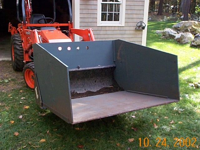

I made this for leaves and wood, but tried it on wet compost, and the trick is to fill up the front, tilt it back then go in for another scoop. I have loaded this more than 1/2 full with compost and no problem with flexing etc..
I had hinges but wanted this to be "no tools" so decided for the slip fit approach. BTW the holes in the back allow one to see the bucket edge w/o standing up..
This is 4' deep, 4' 6" W x 22" High front and 34" high in the rear. I calculate about 50 Cu Ft total.
Carl

Here's a shot with the sides and back removed. Good for limbs, and other big stuff. Also makes a good workbench when resting the bucket on a sawhorse or stump etc..
