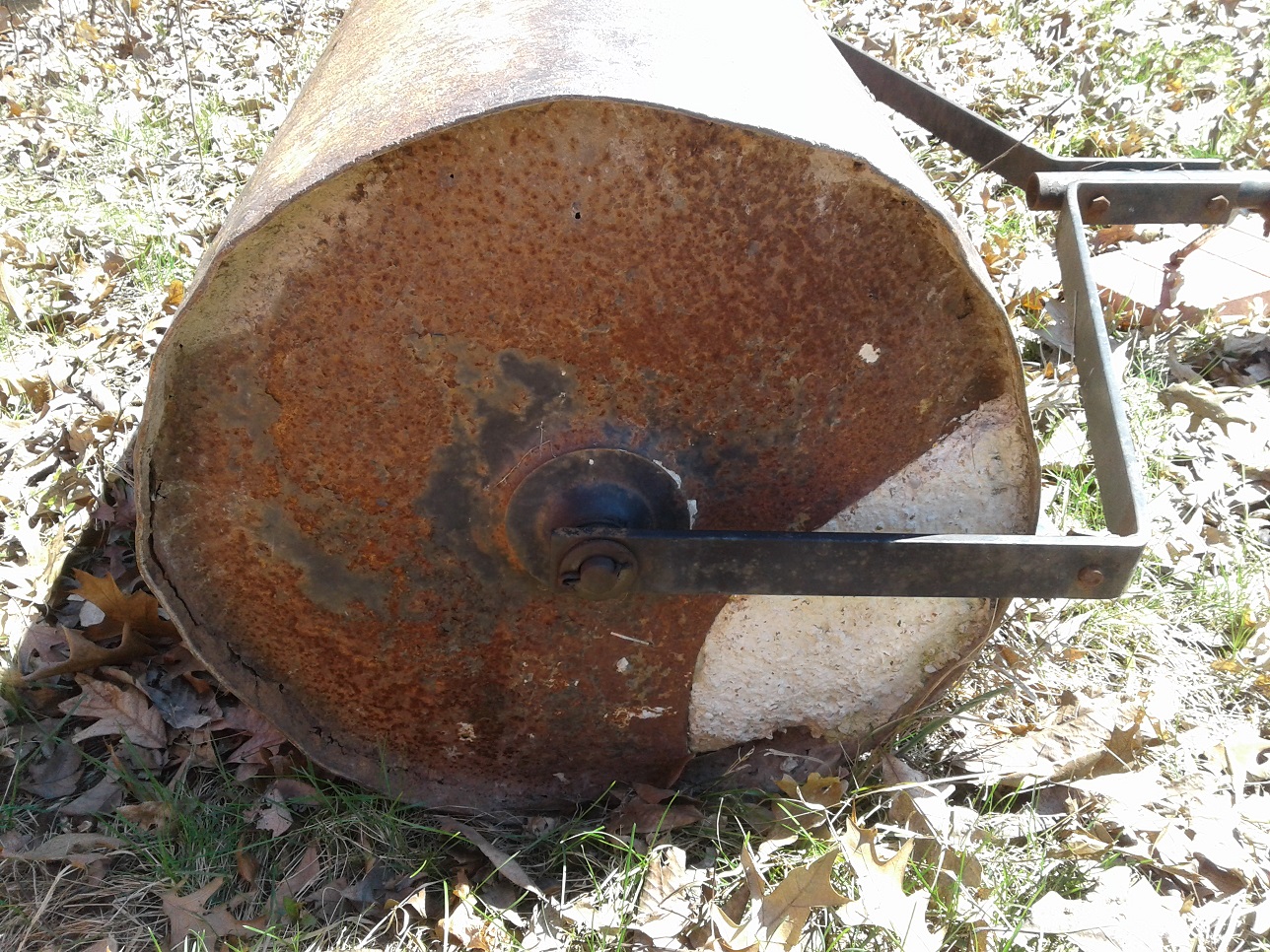

I just ordered an RK24 last week. Still waiting for it to come in.
One reason I wanted a diesel tractor is I have a lawn roller that now
weighs around a ton and my 18.5hp tractor has a very hard time pulling

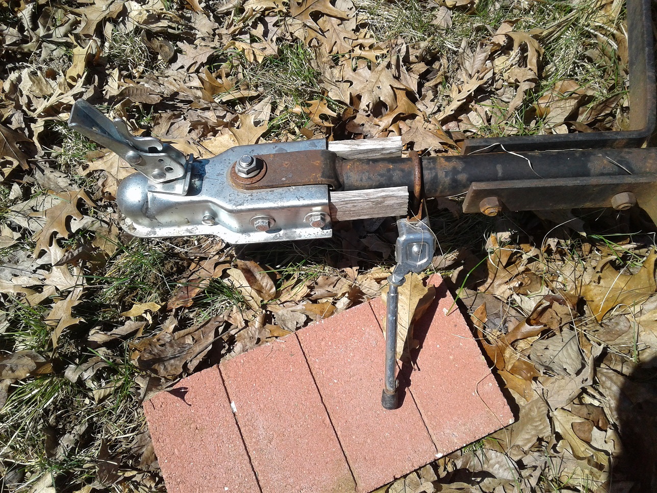

When the BH is removed will I be able to hook the roller to the tractor or
will I need a draw bar for the 3 point hitch?

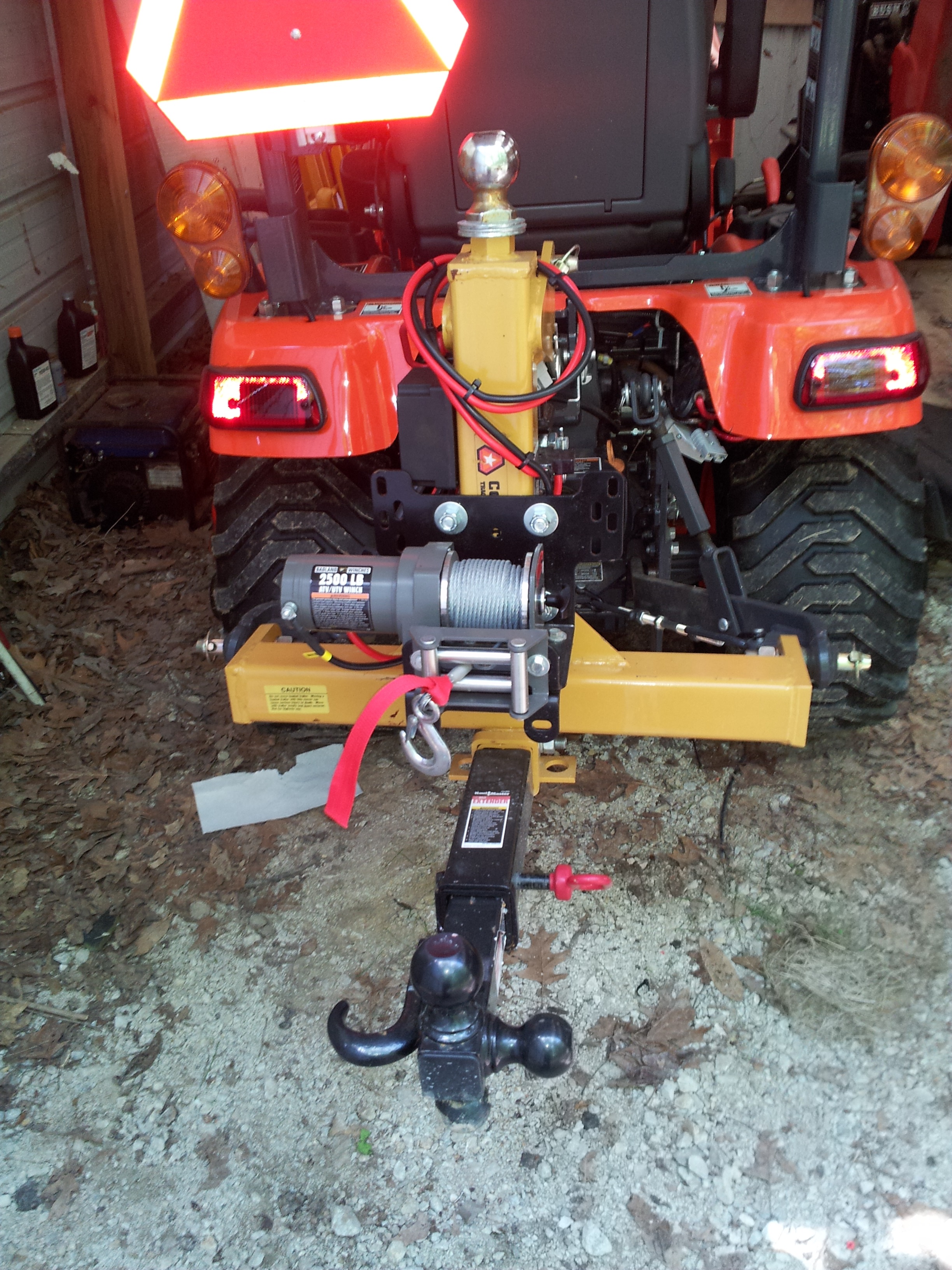

Concrete filled? If so add an automotive coupler on the front and use a trailer mover to pull it. It weighs a ton or more. I also have a 6' Hoelscher rolling box blade. Shears off the mole hills before flattening lawn. Neighbors see this and go out with lawn tractors / turf tires and get stuck. Yes, I have a sick sense of humor.

I have inspected the RK tractors at the Rural King in Gainesville, Florida several times. I am 90% certain RK tractors come standard with a bare rear/center drawbar attached directly to the tractor frame. You will need to bolt on a 1-7/8" or 2" ball to the rear/center drawbar, assuming a ball hitch is the attachment method on your existing roller.

In regards to your drawbar, the RK24 comes with a drawbar standard. You just need a ball or pin depending on your hitch type on the roller.
