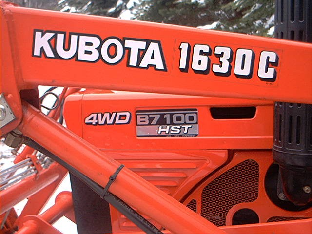

Will a LA300 loader fit on my B7100 HST ? If not what one will.

B7100 had a couple of different loaders to offer thru out there years.
1995 B7100HST fel was... --->
/ ? on fel for B7100 #4
My 1995 B7100 had a B1630C loader. The salesman said the earlier models were not compatible with a mid-mount mower, but that the B1630C was (and since I didn't ever get a mid-mount mower, I don't really know)./w3tcompact/icons/laugh.gif

I don't think that the LA300 FEL will fit your B7100. At least without some modifications. Here is the information that I have.
For the B7100 HSD:
The B1630C is the Kubota model number for the FEL that is compatible with the mid-mower (reference: 1995-1997 vintage Kubota FEL sales brochure).
The B1630 (no "C" suffix) is the Kubota model for the FEL that is NOT compatible with the mid-mower (reference: 1995-1997 vintage Kubota B7100 tractor sales brochure).
From the same Kubota FEL sales brochure, as well as a newer one (2000 vintage?), there is no mention of an LA300. There is, however, an LA301 "Quick-Attach" loader that is designed for the B1700E/DT/HST and the B2100E/DT/HST.

Kubota makes a LA350 and a LA350A for my B2150; on one the hydraulic controls stay on the tractor when the FEL is removed (I suppose that this is so the controls can be used on other implements such as a front blade), and on the other the hydraulic controls stay with the FEL when it is removed.
As mentioned earlier, the two Kubota FELs sold specifically for the B7100HST are the B1630 and B1630C, where the difference is that one is compatible with a mid-mower and the other is not.
In either case, if the LA300B will fit on your B7100HST, then it would make sense to me that any LA300 will fit on any B7100HST. There may be limitations such as mid-mower compatibility, but I'd say it will fit.
For the benefit of anyone else reading this post, the FELs for the B7100D/E (gear drive models) are totally different from the FELs used on the hydrostatic transmission B7100s.
