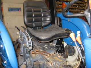

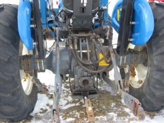

Have a 1998 New Holland 3930, would like to add joystick control to the front loader (new holland 7310). It is currently running off of the 2 rear remotes. I would like to be able to use the rear remotes for other attachments, hydraulic top link, raise and lower sickle mower. What would be the best way to accomplish this? Thanks much for the help on hydraulics. Justin

so, you are using two (rear) valve levers to work the loader?...
If the valve (assuming it's a 2 spool valve) has a power beyond port pipe it to a new 2 spool valve w/joystick for the loader...

Could you not take the pump OUT flow and run it to the new joystick loader valve with PB and then feed the PB to the remote valves.. Then run all tank ports to tank.

Yes, currently using the rear remote levers to control the loader operations. What type of joy stick control would be recommended for the loader?

They have made several different control blocks like the one you are using. It appears to have extra plugs on this model. You might be able to plug into those plugged out lets to add your joy stick. Check to see if your dealer has a knowledgeable hydraulic tech. He might help you with your hookup.

Anybody know where to find a power beyond block for a NH 3930 tractor? Looks like the best way to hook up a loader joystick for my tractor. A three port block would be best if available.
