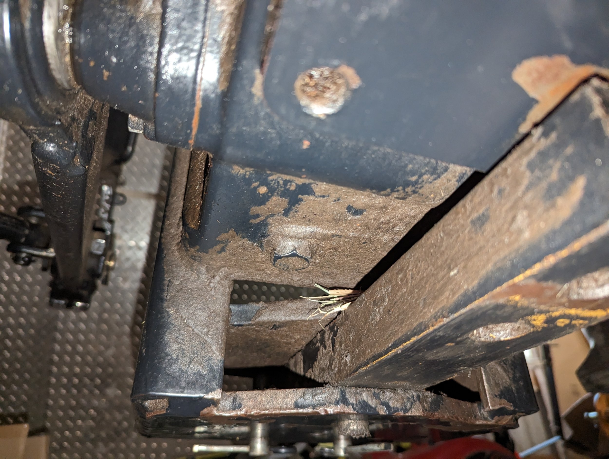

I bought a 2003 TN65 4WD open station tractor that only has 575 hours on it. The engine oil has been changed regularly and it appears that the hydraulic filter has been changed. The previous owner didn't use the tractor very much at all and he couldn't remember if/when he had changed the hydraulic fluid itself. The fluid is clean and clear. I want to change it since it has probably been in there a long time. I bought 15 gallons of the Velocity Ambra 134G fluid recommended by the dealer so I can replace the main hydraulic fluid and the fluid in the front drive components.

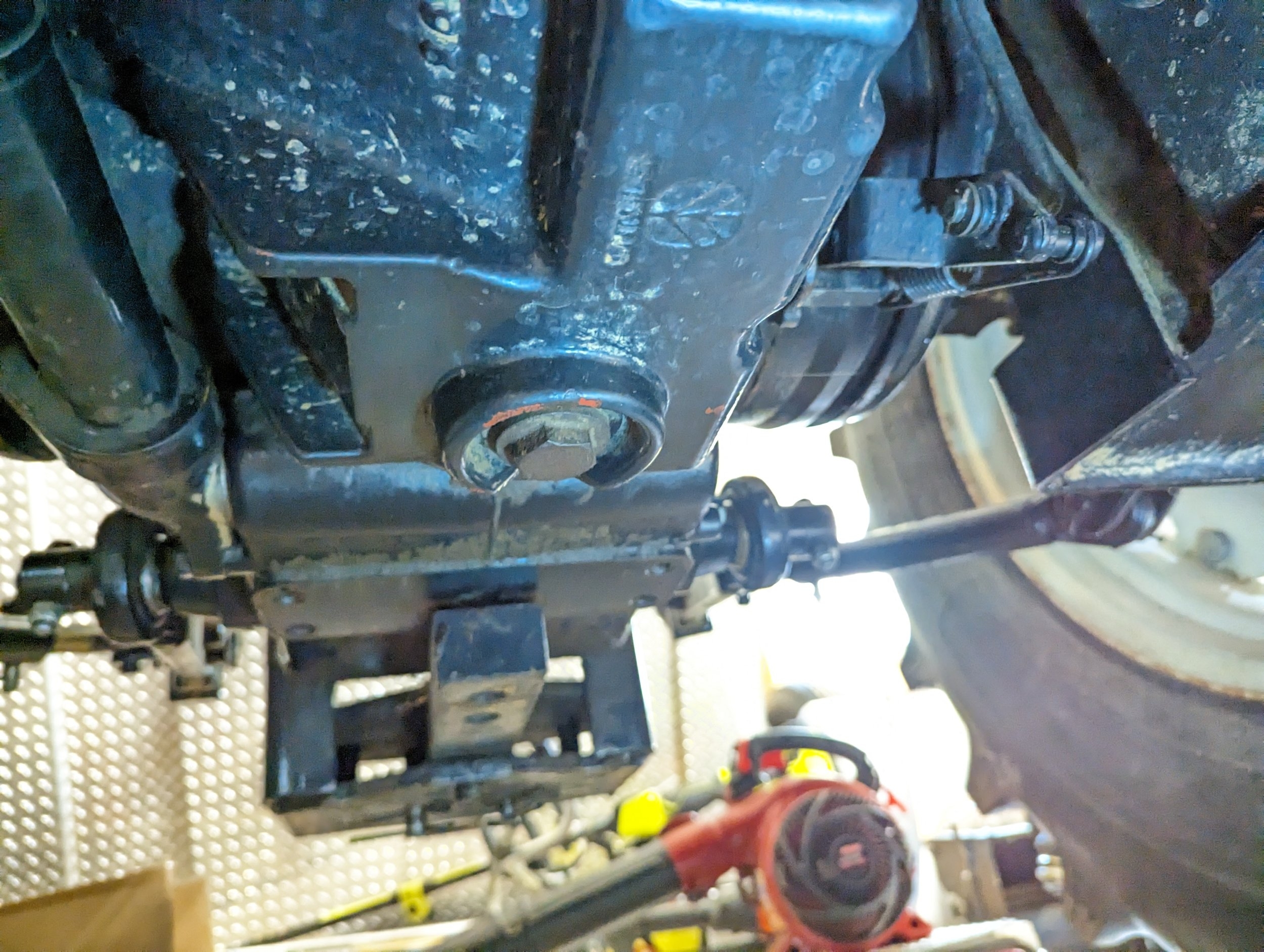

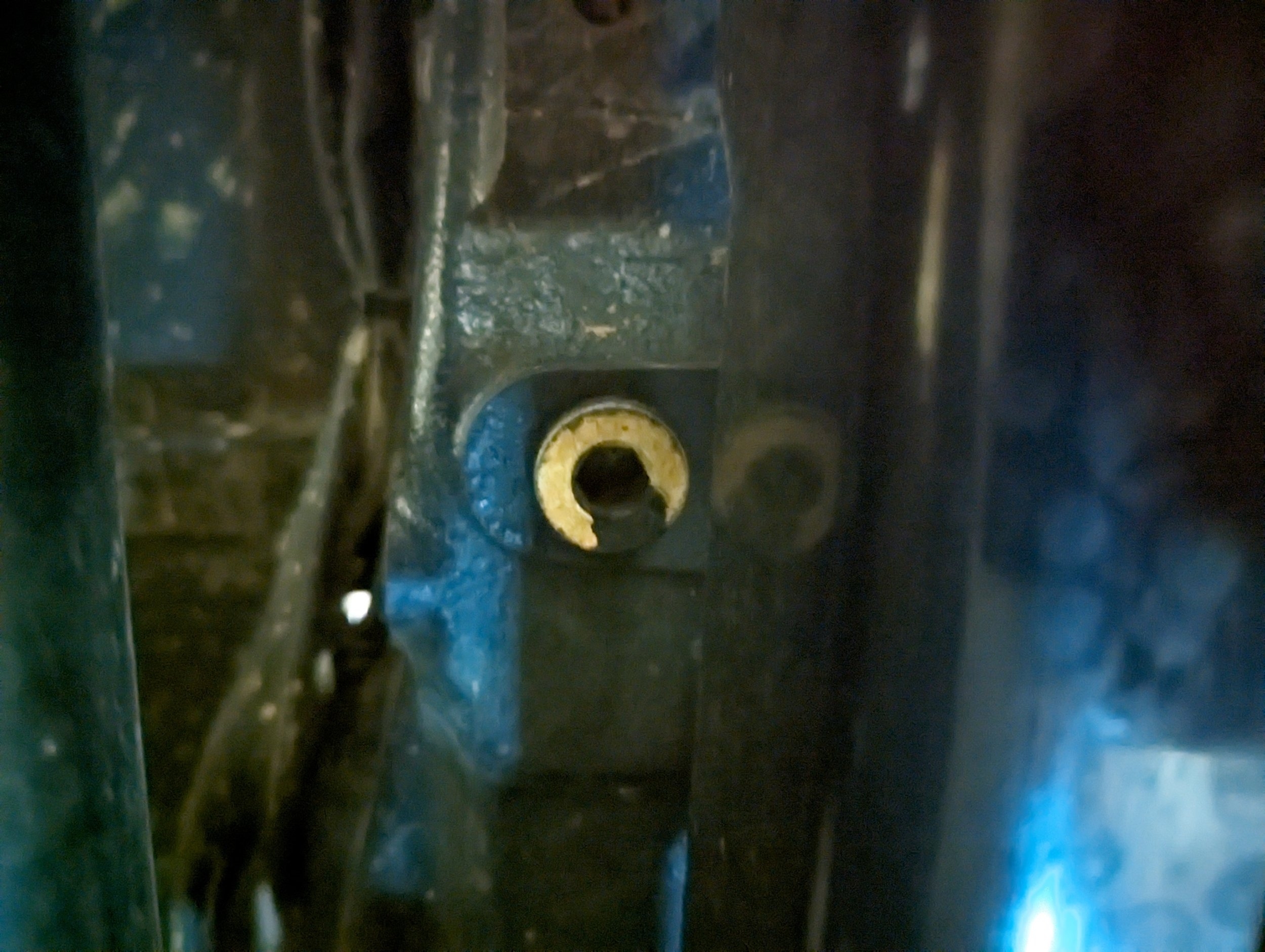

Here is the problem. There are supposed to be four drain plugs and I can definitively locate only two of them. The big 27mm drain is obvious. The one on the rear edge right under the drawbar looks legit. I'm not sure about the other two. Here is what I think. Can anyone confirm if these are the correct ones?

The first picture above is obviously the big 27mm drain. The next two are the ones I am not sure about--one is located on each segment of the transmission case. The one on the right is located at the rear under the PTO shaft--I believe it is correct. Any insight would be greatly appreciated!

All are drain plugs. They are located at the low points that oil would be trapped within the case. You 3rd picture is dark and it is hard to tell where it is exactly, but you really can drain 99% of the oil with the large plug and the rear axle plug.

Just a post-change follow-up in case another inexperienced soul goes down this path in the future. The four plugs pictured above were correct. As TractorTech said, the rearmost two plugs (the big 27mm plug and the one under the PTO shaft) were responsible for almost all of the oil coming out. The front two plugs were lucky to have 0.5-1 gallon total. I used two 5-gallon buckets for the main drain operation with heavy disposable gloves on. I pulled the 27mm plug and kept it close to the drain hole. When the bucket was close to being full, I put the plug back in and swapped the buckets. The second 5-gallon bucket also held the rest of the fluid from the rearmost plug (under the PTO). I used a third 5-gallon bucket for the front plugs (not much fluid came out) and a regular oil pan for the massive filter. The fluid coming out was in very good shape (visually). There were minor amounts of metallic dust on the magnetic plugs, but nothing serious.
