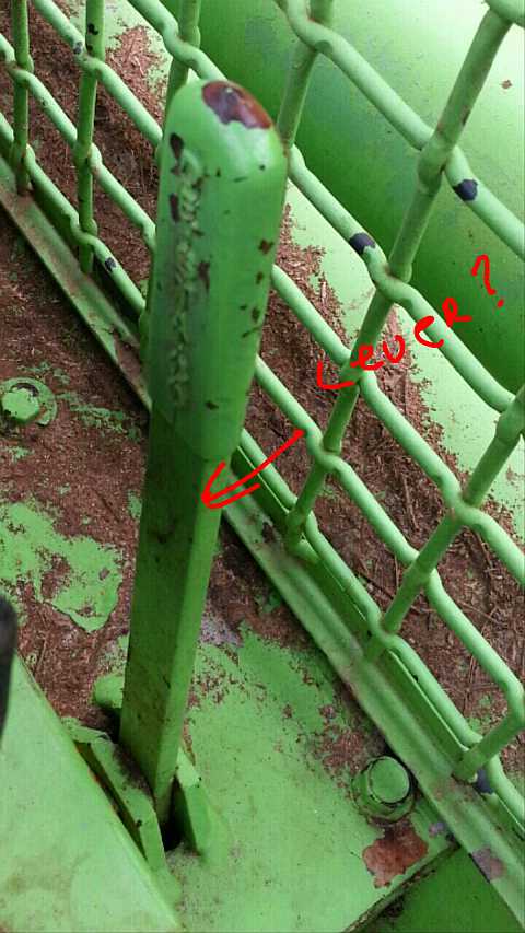

Hello, I just bought a OMC mustang 440, he said he thought it was early 80 or late 70's, im not sure, it has a Wisconsin v 4 VG4D
I am not a equipment operator at all, although I have used a back hoe and track hoe a couple times, this is nothing like a backhoe

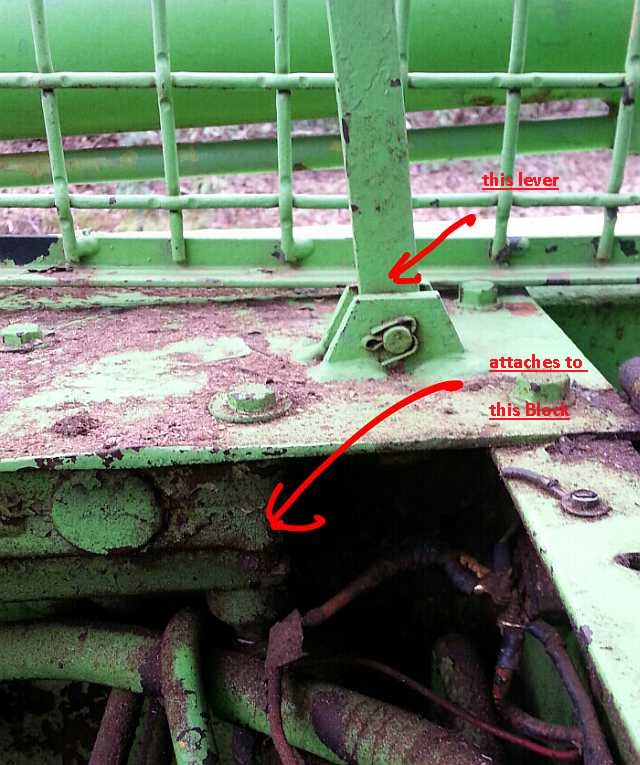

I would like to know more about it and the controls, I know the foot controls are for bucket two centers ones are for aux (nothing hooked up to) and the two stick forward reverse, but there is a lever on the left side of seat that goes down into the engine area and attaches to some type or hydraulic valve, I have no idea what this is used for
it is going to need some repairs, such as a starter ring gear, that large wide drive belt that runs for looks to be hydraulic pump to shaft that go outside to wheel area,
and it has a line leak, there are little things that are worn with it, but it runs, moves the bucket smoothly up down an d tilts,
, BUT it does not stop moving when you release the drive levers, like no brakes at all. IOW when they are in the neutral position it will roll, I bought it on flat land and did not catch that, he loaded it and a friend of mine unloaded it here, that is when he told me.There is no using it on a hill right now!
so what makes this stop besides pulling sticks back to go other direction? is there no "brake" to this at all? i have drove my friends New holland skid steer once and you could park it on a hill and walk away from it. BTW, I did send a message to mustang this am asking for a operator manual on it. and gave them the serial number so I can hope to find what year it is. I have seen some information for other model mustangs, but not a 440.
any help or pointing me in the right direction would be great, thank you - some pics attached is i can

Tom, I just posted over on your new member thread. The left and right levers control 2 friction clutches on each side in the chain drive. When you push forward 1 clutch engages the other stays in neutral to move forward, opposite clutch engages when going in reverse. The lever on the side control the variable speed drive clutch, move the lever 1 direction will make the hydraulic cylinder on the drive clutch move inward to increase diameter of area the belt rides on the pulley = increasing travel speed. Move lever opposite to reduce speed but increase drive torque, power.
As stated in my other post, this is exact same machine as a John Deere model JD24.
