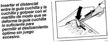

Page 24 of the instructions posted above does mention using a hammer:
"3)Blade holder adjustment for all point teeth cutter bars - to adjust the blade pressure, use a suitable spacer and a hammer"
The next illustration shows a hammer blow however the written instructions are cut off and only the non-english language portion is displayed.

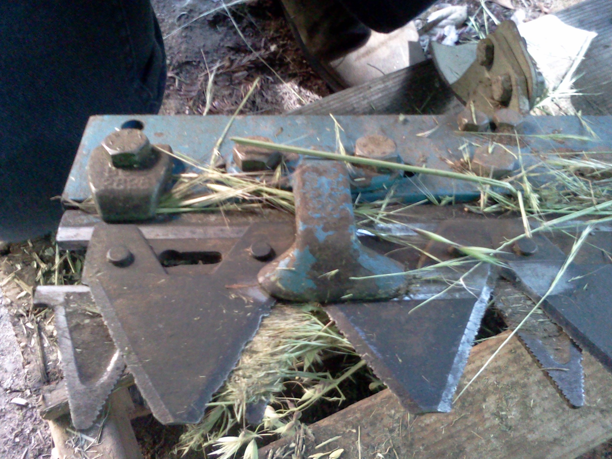

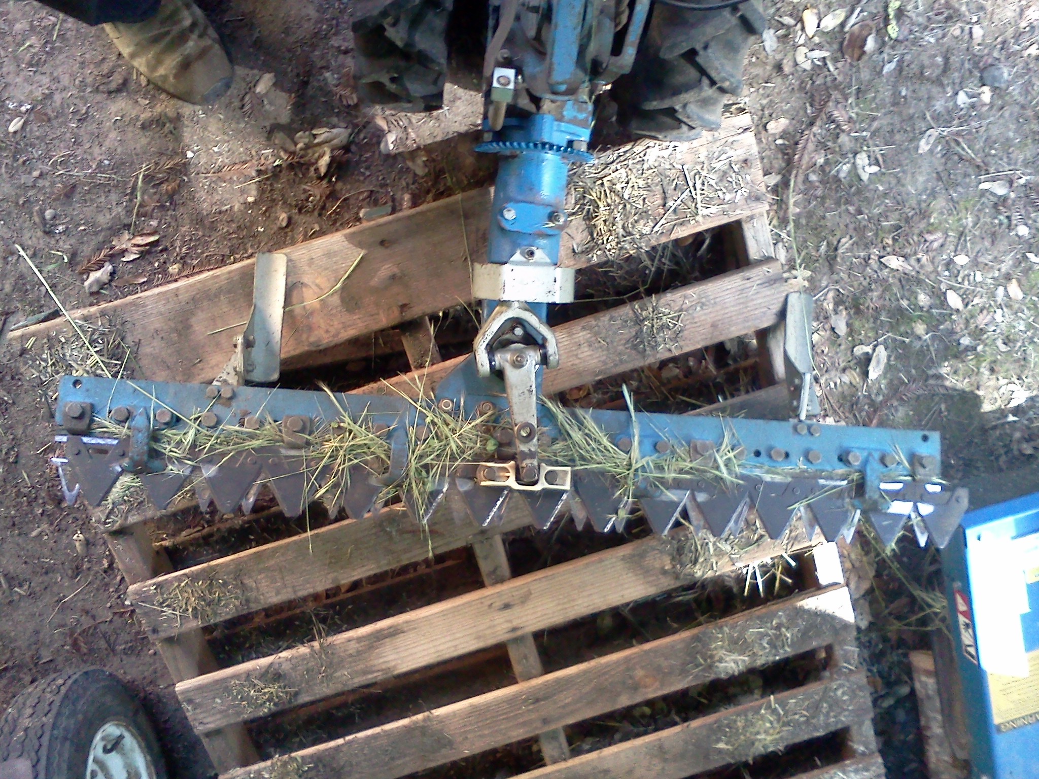

Sorry for the long absence. I was on vacation and then when I came back I was dealing with other stuff. I did finally take some pictures.
It is a 715 tractor (originally acme but re-powered with the Kohler command pro from Joel at earth works -- thanks to this forum for turning me on to that!), not a 725. I only have one mowing speed (slow). I also have a 20" brush mower. It is good, but with bumpy uneven ground (most of my property) and small wheels, it tends to get hung up (tractor supported by engine guard and mower with wheels in the air). The sickle bar much less so. Some areas I would like to keep reasonably presentable (not like a lawn, but at least like a field you would walk through with normal shoes). Also I want to reduce tick habitat. But I would also like to try to cut grass and weeds to fee to my goats (so I don't have to buy them so much hay). So I think I will need to have both kinds of mower.
The dealer who sold me the mower was not talking about the rivets that hold in the teeth. He was definitely talking about adjusting the force with which the sliding teeth are pushed against the stationary teeth. Also there is a bar that pushes the sliding teeth forward which adjusts much the same way. It definitely SEEMS to be a BCS mower. Many of the parts say BCS right on them (cast parts with BCS cast into the part).
Since my first post, the grass grew quite a bit, and I found that it is much easier to cut when it is tall. It is junky weedy grass all gone to seed. I raked it into a big pile anyway and plan to feed it to the goats. I still have acres to mow. It is a slow process and I don't have enough time in any one day to do it all. I may invest in a more serious tractor (853) and a wider brush mower of some sort. I got this tractor "for free" when I bought a chipper. The Acme motor had thrown a rod through the engine case so he said "if you want it take it. If not, leave it. Same price for the chipper either way." There is also an old mainline tiller "for free." Pretty good deal.
Anyway, I went back to the guy who sold me the mower to buy a throttle cable (he is actually an experienced BCS dealer) and told him about my uncertainty. He found another old mower in his bone pile that had similar adjustment scheme and explained it in more detail. I will try the revised procedure, and if it works (and if I remember) I will let you know. I am much more confident now that his instructions are correct. I was striking at around a 45 degree angle. But apparently you really need to strike the holders so that the hammer is moving parallel to the teeth. A "head on collision" if you will.
Thanks to pookins for the video links and sharing experiences remembrances with the sickle bar! When the grass got taller, it was somewhat peaceful (with ear protection) watching the taller drier grass fall away in waves. And thanks for catching the picture of the hammer! That does look more like my unit. Somehow I missed it on the first pass.
What else. I think my mower is 40 inches wide. The ground is loose, so turning the mower is not too bad. It is helpful to have an already mowed area at each end of the run where you can make your U-turn. I was alternating directions. For me it would be hard to mow the same direction, as I am mowing in a side-hill orientation, and it is much easier to always turn down hill.
See pictures of mower.

Hey Keith,
I too went and looked at a mower I have from 1982 and you are right about the "hammer" method of tensioning. Yours surely is a BCS mower. The one in my boneyard has long rockguards that stick out twice as far as the sickle sections. I've been told it was not a very fun mower to use. Looks like you have a mulching or combination mower.
