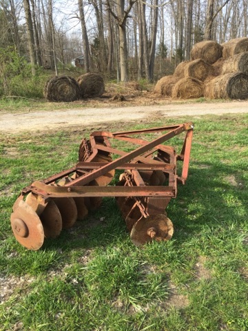

Hi,
I just bought a 3 pt. disc. I got it home got to looking closer and I can't quite see how the toplink is supposed to work.
I think I might be missing something.
Can anyone identify the brand? I couldn't find a tag anywhere on it.
Thanks,
Ken

From the picture I believe the top link would connect where all of the braces come together. Discs don't have a floating or pivoting top link like a rough cut mower does.
No clue on the brand of disc though.

Could be a Southeat Mfg disc out of Neodesha, Ks? Not 100% sure? Ken Sweet
