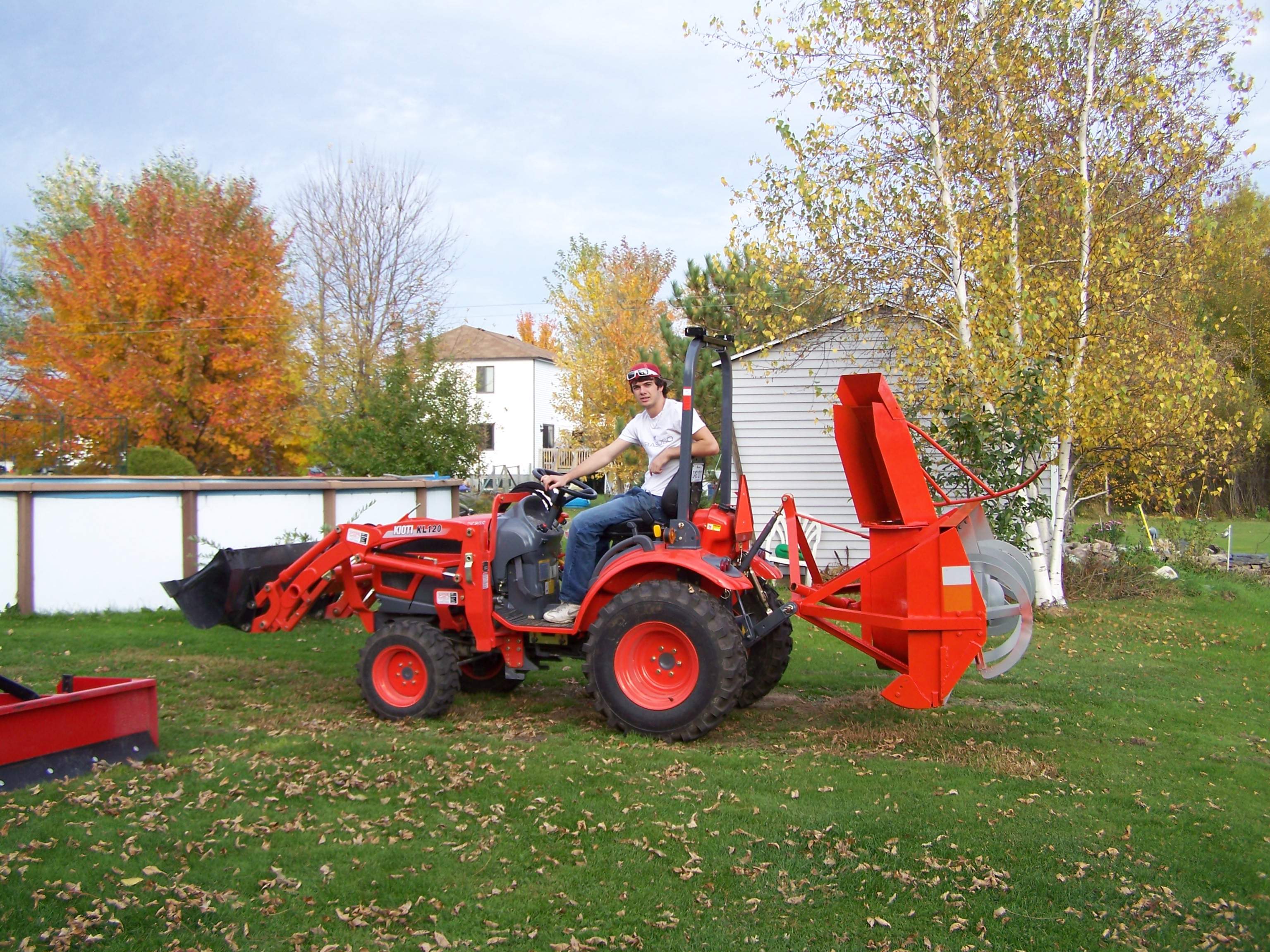

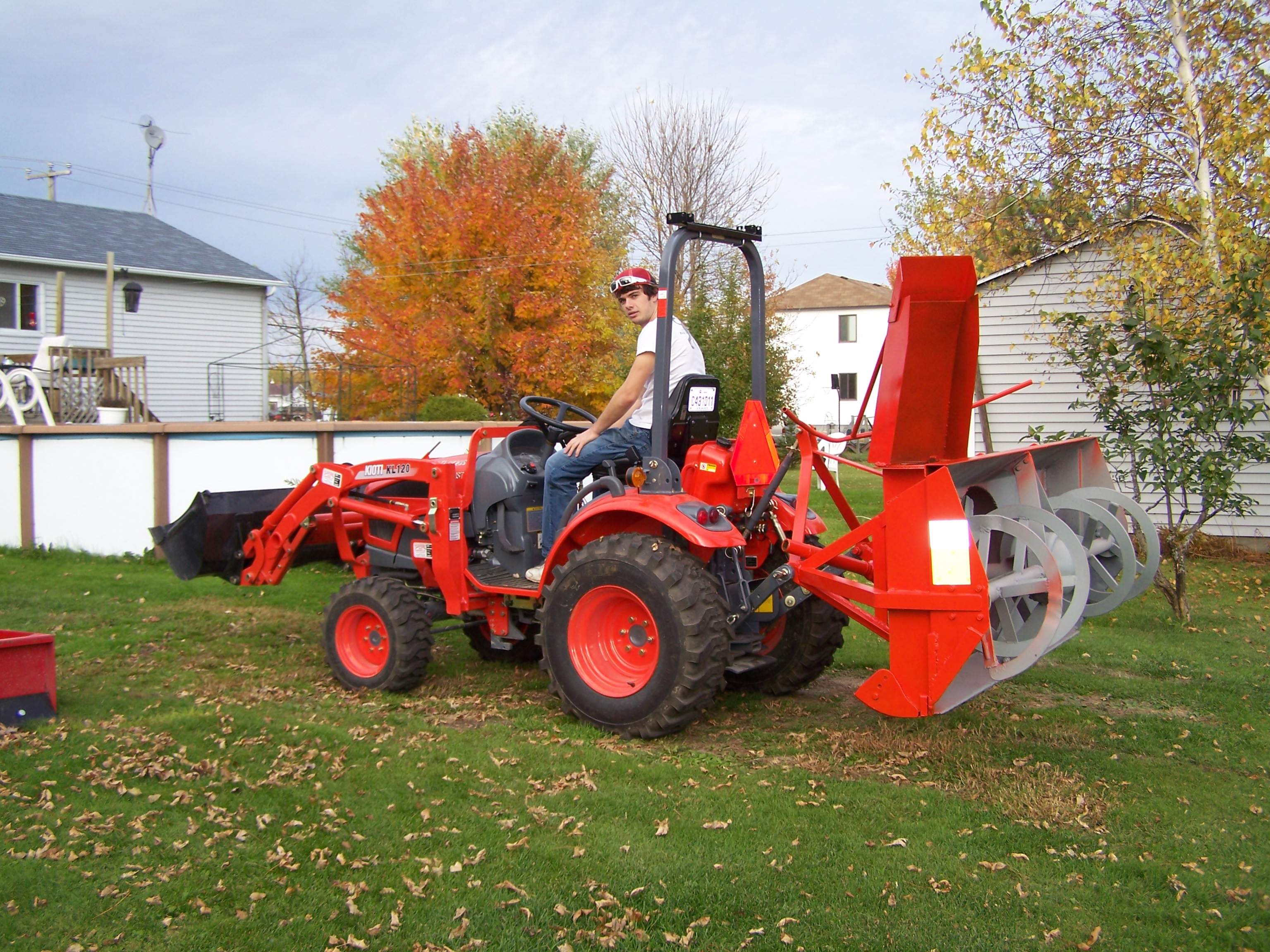

I bought an old snowblower for cheap ,
If someone could take a look at the pictures and give me an idea of the brand ,it would be appreciated .
I got no clue ......
I have only paid 250$ for it....only needs a good paint job and welding a few cracks .
The Pto shaft goes trough the rear end into a Differantial instead of a gear box .
Were these blower hard to turn ? it is 60 inches wide
Would my little Kioti CK20 22hp , be able to turn it ?

unless there's something wrong with it ,you shouldn't have any trouble with your CK20 running it.
I have a Smyth 60" and the only time it'll bog down is in very heavy wet stuff more than a foot deep or in piles. Then just slow down with your hydro.
Fresh dry snow over a foot I can go full speed in reverse ,no problem.
Probably the only problem your likely to have is stiff neck after an hour or so.

Shucks, Prevost is 15 mins from here.
Shame, we could have shared a coffee and talked up tractors.
From the pics you post it looks like an earlier model that probably uses an old car differential as a gearbox. Think they were commonly used on old ford tractors and the like.
Probably much more rugged than the modern units.
As to brand name, dont bother, just lube everything and at worst change any questionable bearings before winter.
Also repair any bad welding as often older blowers have tossed a few rocks and kinda beat up the welding.
Must say at that price you can't go wrong.

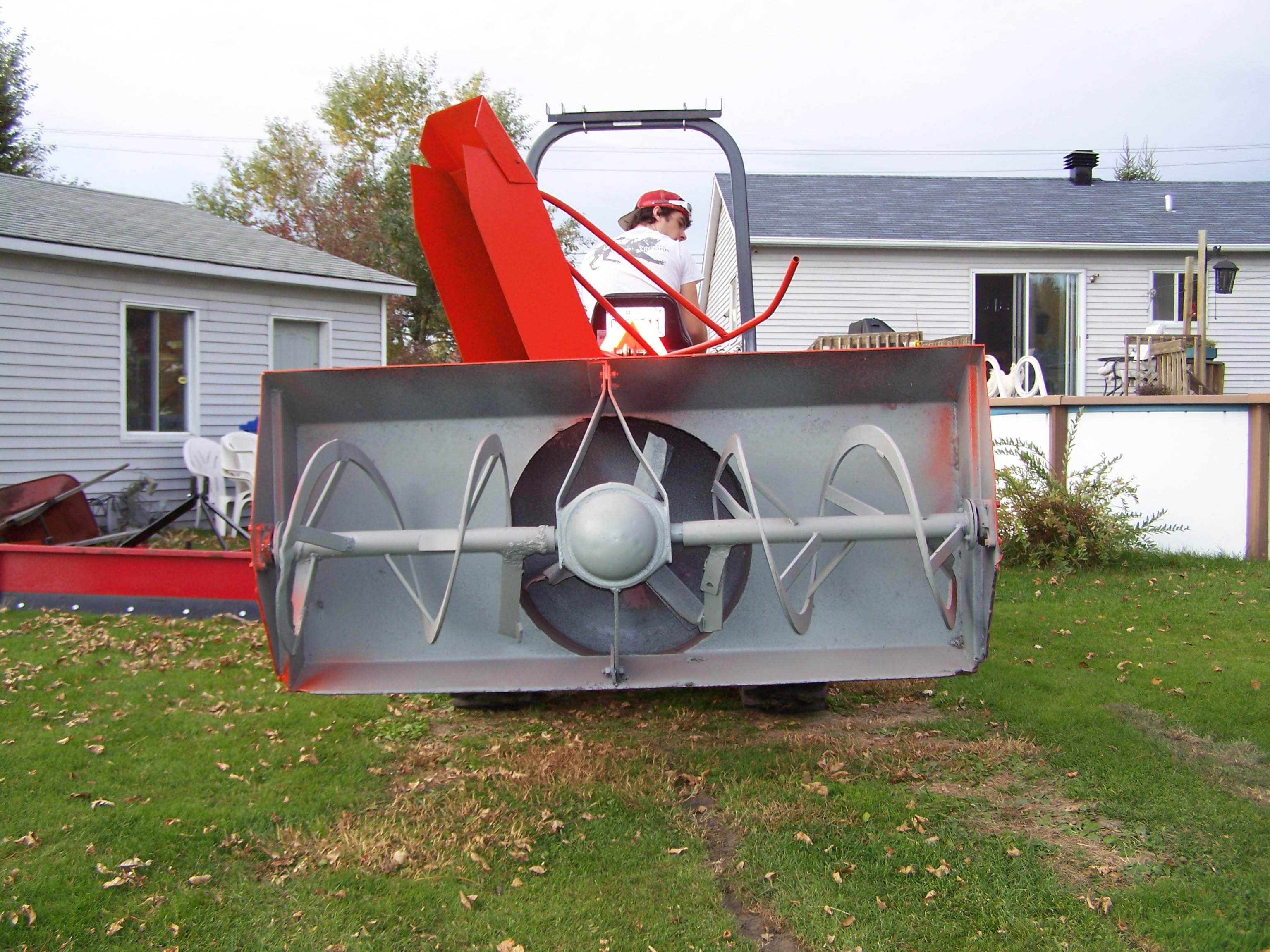

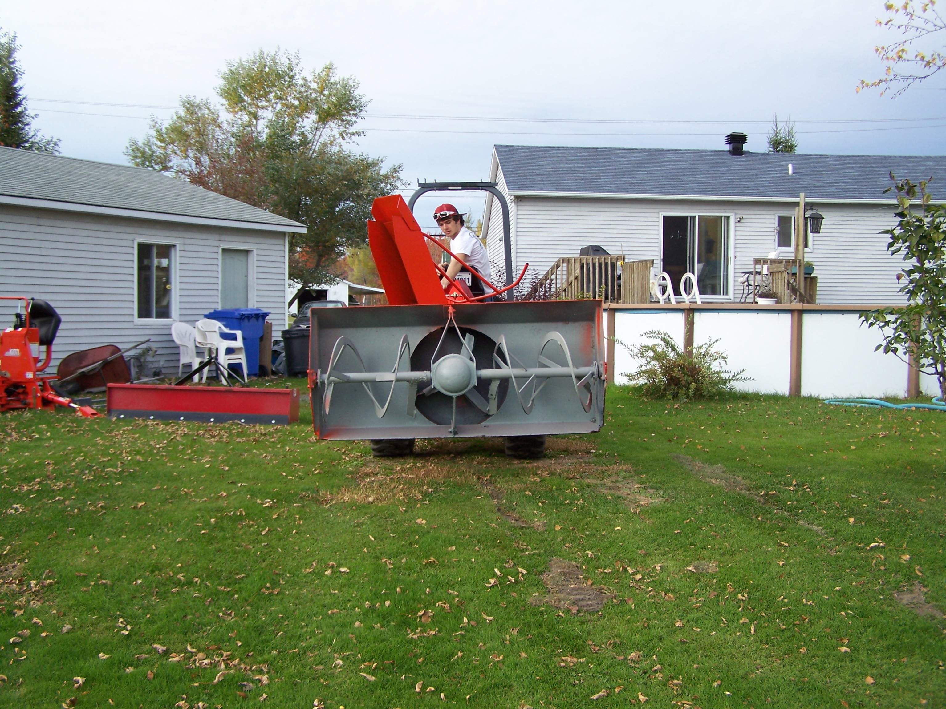

Here are pictures of the snowblower i just repainted it today !
