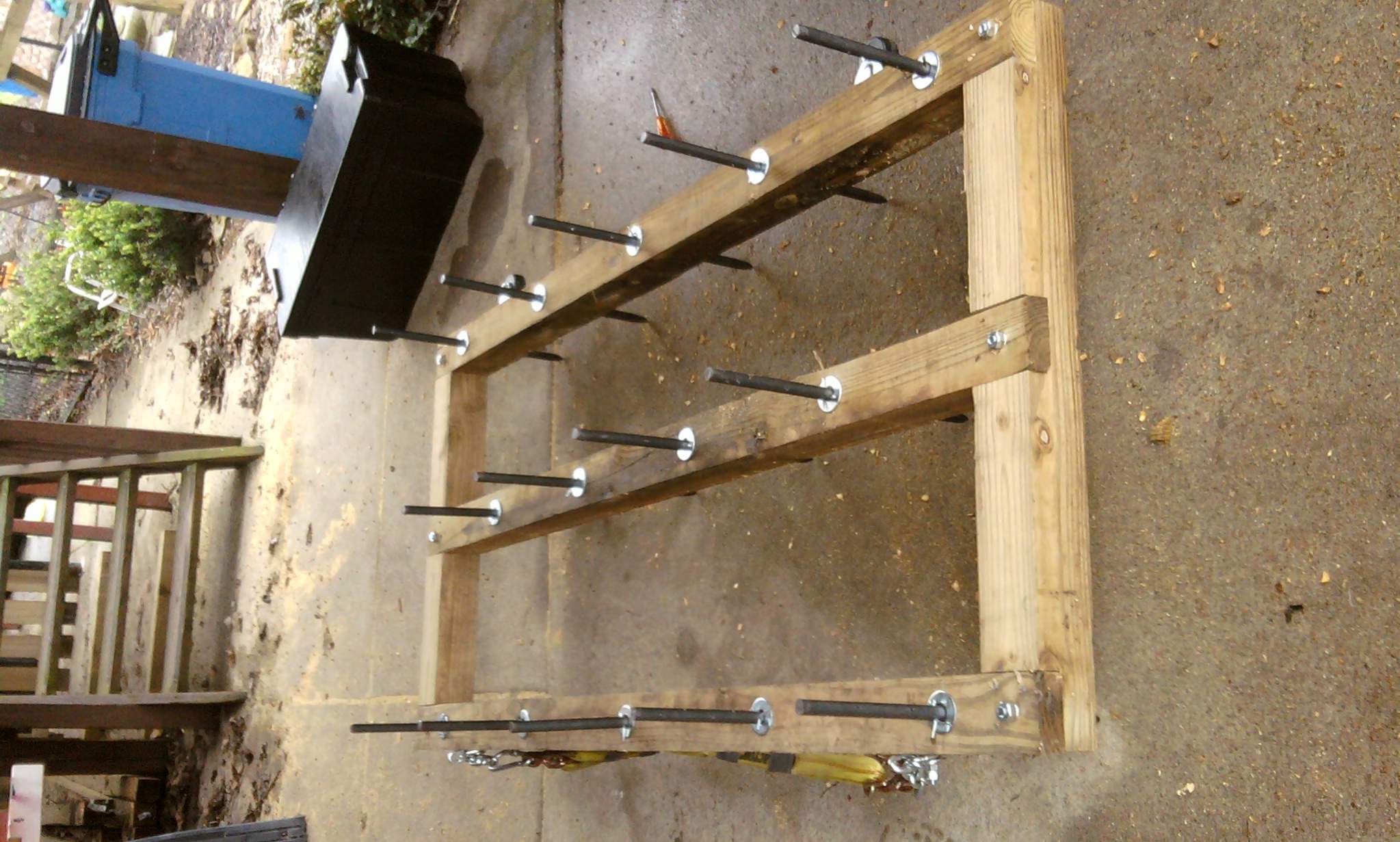

MESSMAKER
Veteran Member
May 19, 2009
2,231
Bluegrass,KY
DK4710SE
I have been doing some garden plowing with my tractor, but I only have a walk behind tiller,so the big gardens took some time. I needed a way to smooth it out before I brought in the tiller. The only one I have access to was an old drag type that is a bear to transport. I was just going to use a drag, but I took it up a level. I can pull this behind my tractor or I can hook it to my bucket hooks on my front end loader and carry it, pull it or pick it up at the end of the row in a narrow plot. I can remove the spikes in about ten minutes for storage or use as a regular drag. I put wheels on the back so I can roll it around on it's side and I set it up so I can hook a section of chain link fence on it to help prep the ground. I had the wood from a previous project but I had to buy most of the hardware. The total cost was $46.

Top notch. :)
