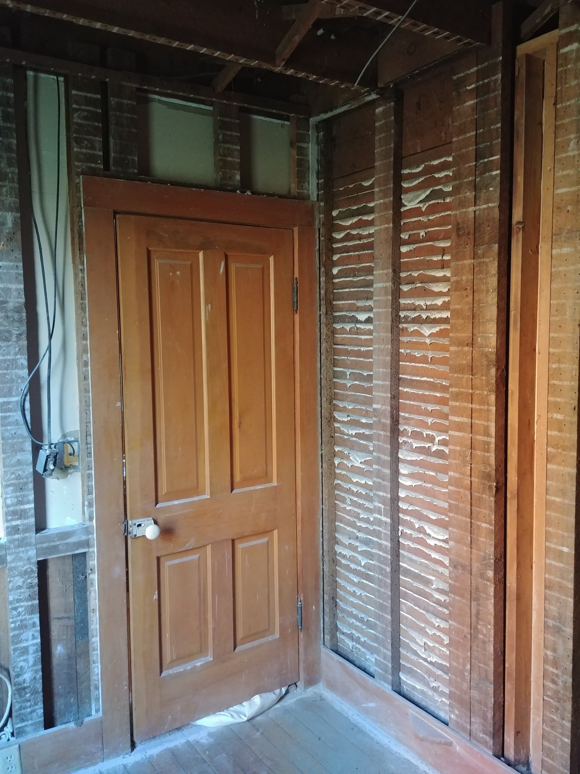

The homstead here was built in 1846 using full dimensional lumber. The construction techniques seem odd by todays standards. The sequence was to lay an 8x8 sill beam, set first floor joists into notches in the beam, tip 16' wall studs clear to the second floor. Add a stringer for the second floor joists, set the second floor joists on the stringer, sheeth the walls with up to 1x16 planks, lay tongue and groove flooring on the two floors. Interior walls have wall studs flat leaving only 2" inside the wall- no need to leave room for utilities. Plaster was a mixture of lime and horse hair for added strength. The plaster is different than more recent from the 1920s, much softer and grainy.
