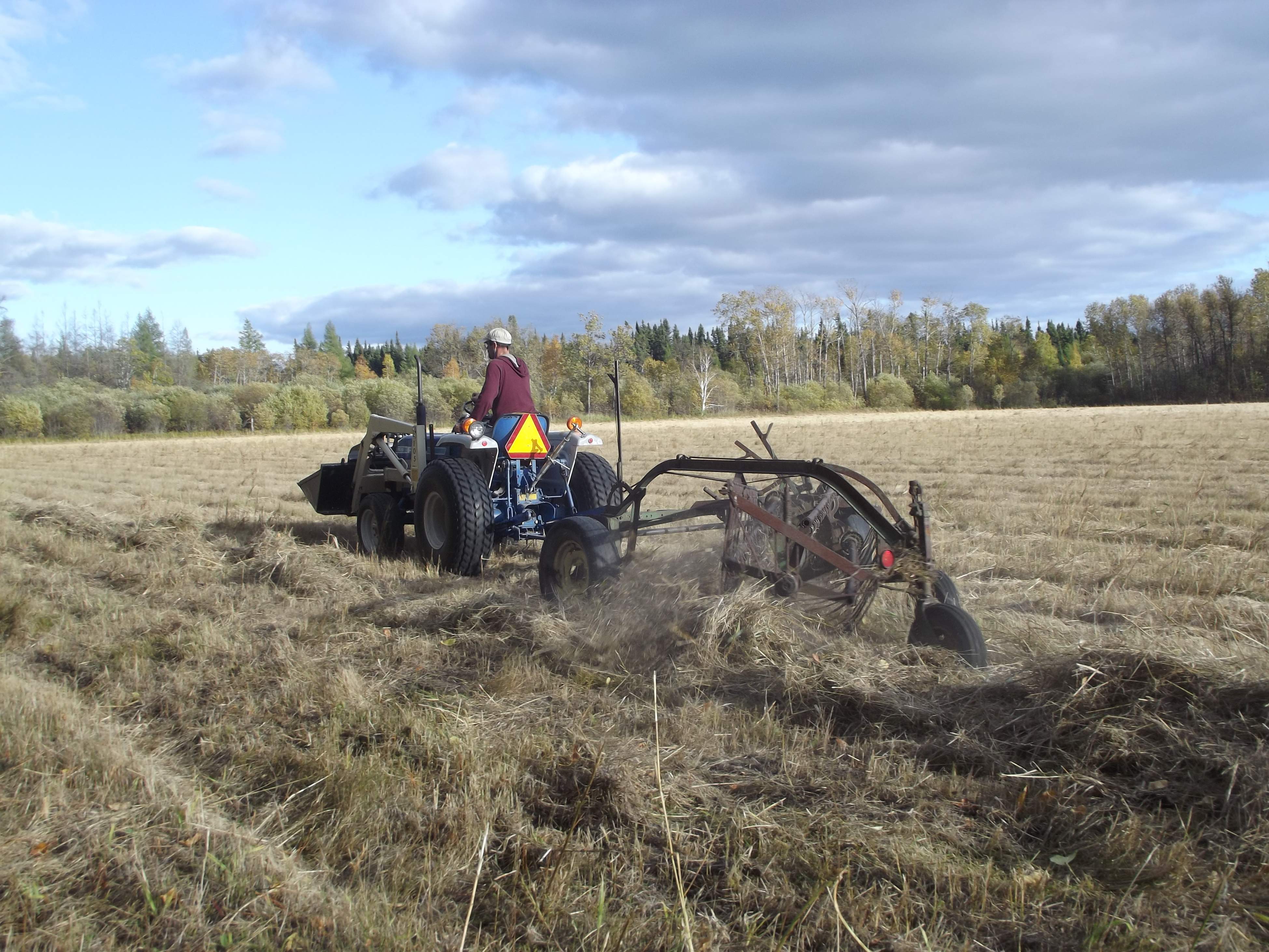

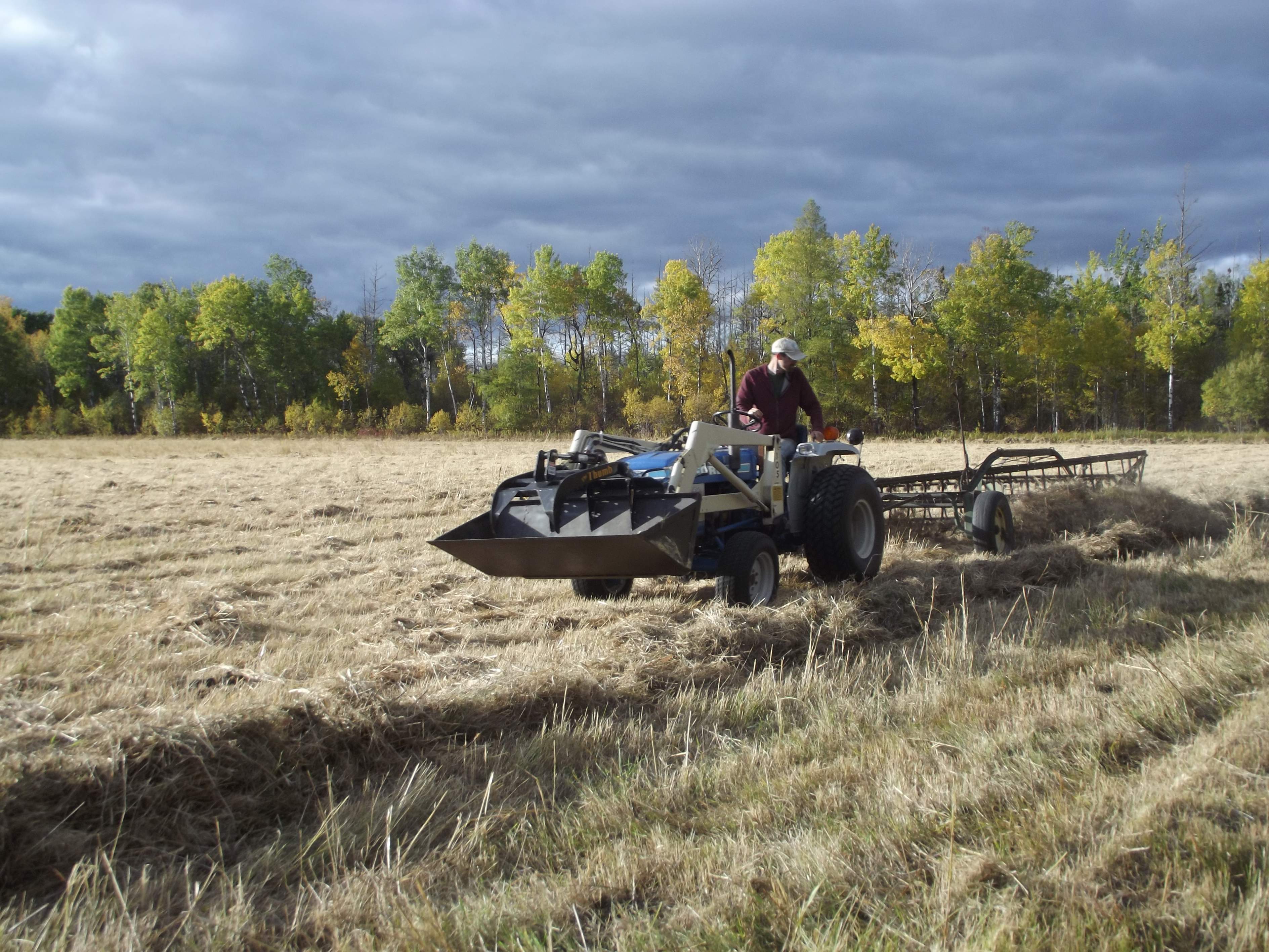

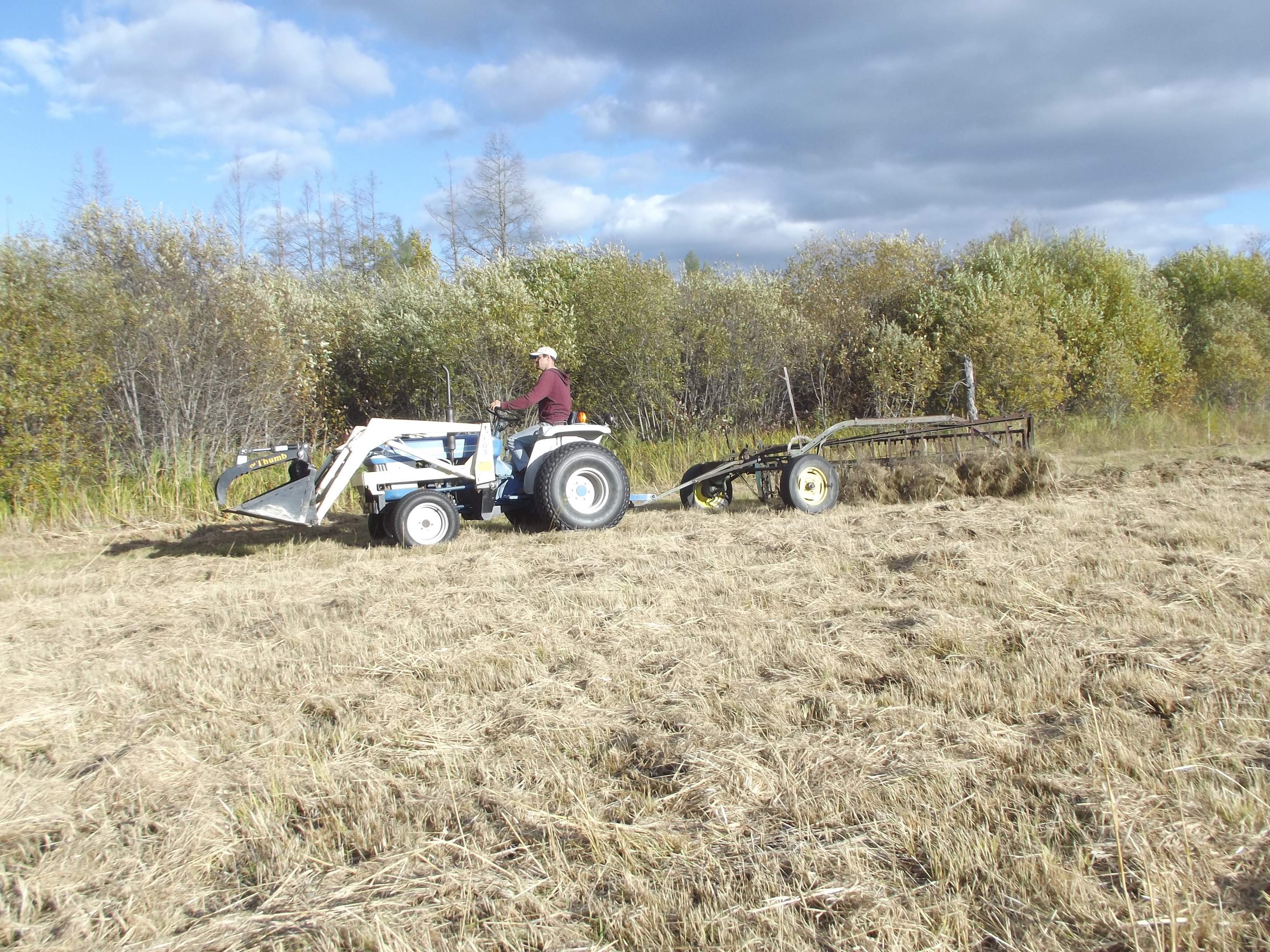

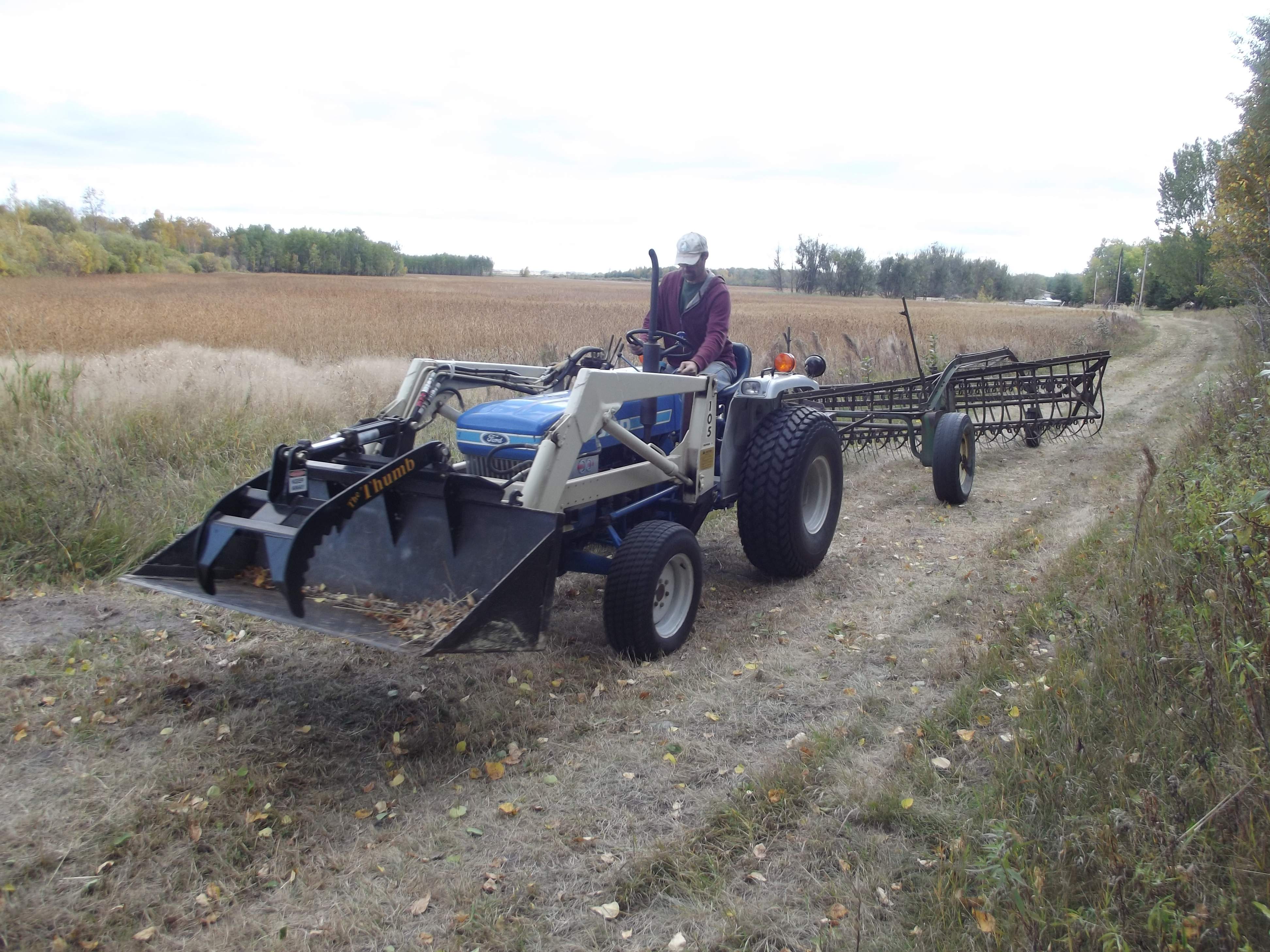

A short while back, I had bought a vintage John Deere side delivery rake, hoping it would do a satisfactory job raking my hay field. Short answer: I works great!
Now for the disclaimers:
1. This field is ROUGH! I imagine it was worked up many years ago but never planted. In other words, it was never meant to be used as a hay field. All the grass is volunteer, and I'm hoping to convince my renter to pull his big field roller over it after it rains sometime soon.
2. This field was cut with a rotary cutter instead of a sickle mower or other type of hay mower. I used the RC because I had absolutely no idea what to find in the field, and I could shave off some of the highest dirt mounds this way. (See no.1)
3. The "hay", if you can call it that, is pretty short and past its prime. I merely want to rake it off the field to help the grass grow back better and thicker next spring, and to chop out the weeds as part of my field renovation efforts. This is not being cut to feed to any animals, so quality is not a concern at this point. Just removal.
4. I experimented with going around two times counterclockwise and one clockwise to maximize my windrows for ease of removal. (See nos.2 & 3)
All things considered, I was very pleased with the results. By next year, I should be cutting and raking the "real" stuff!

Your rake is a John Deere 594LW. The LW stands for little wheel or low wheel. Rake was also made in the 594 model which has 36" tires on the front instead of 15" or 16" size like the LW model has. The LW model has jackshafts and chains to compensate for the height and gearing difference for the conversion of large diameter wheel of the 594 to the small diameter wheel of the 594LW. Otherwise most all other parts interchange.
These old rakes do a fine job of raking. Really the only thing that they do not do well is road transport behind a pick up truck - rear wheels will shimmy like crazey if you try to go too fast - may be fine at tractor road gear speeds though if caster brake pads are in good shape (most caster brake pads are either out of adjustment or worn/rusted away altogether). On hilly terrain these rakes can have a tendencey to crab steer down the side of a hill, but this can be easily overcome by altering your travel direction on the hill to up or down it - not accross the side of it.
Anyway, I use two of the 594 rakes on my hobby operation. I have refurb'd them both of them by custom making all new bushings where needed and replacing all bolts with grade 5 hex heads. One of my rakes is around a 1938 model and was in pretty good shape with minimal wear (bought it from the original owner who was in is 90's - he and is dad bought it brand new). My other one is about a 1948 model and it was in poor shape when I started, but is fine now after several custom bushings. Mine are on steel wheels and never leave the place. That old JD caste iron is quite weldable too if need be so if something breaks then do not automatically junk your rake - chances are it can be successfully welded with good results.
Loose hay is quite doable (and very economical) for a small time operator for their own personal use. However, if you want to sell it then it will almost certainly have to be baled unless you just get lucky and find that one person willing to buy it cheap. With it baled then your potential customer base is much larger. Of course owning and maintaining a contankerous baler is not always practical if you only have a few acres nor is it easey to find someone reliable to bale it for you if you only have a few acres.
