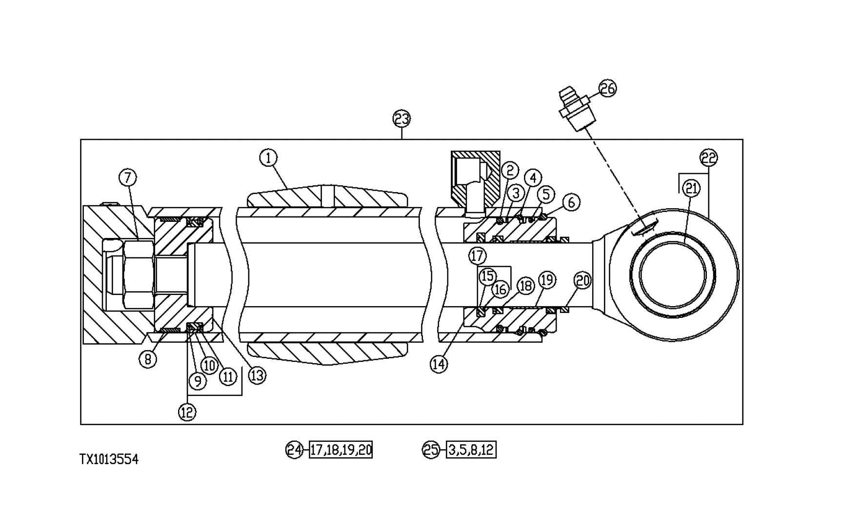

It was intended as a general question about a common problem...although today I am having trouble with the bucket tilt cylinder end on the JD 310.
I bought the machine with a few hours on it - about 6000 hrs - & no idea what type of grease the DPO used. Incompatible greases can harden like concrete. I hope that isn't what happened.
The bushing is part 21. The 1/8" NPT zerk tests ok. It is unfortunately situated in a machined recess that can catch & hold water.
