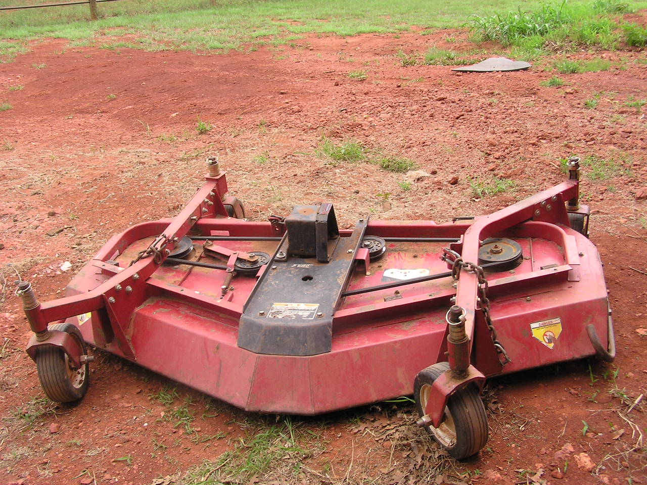

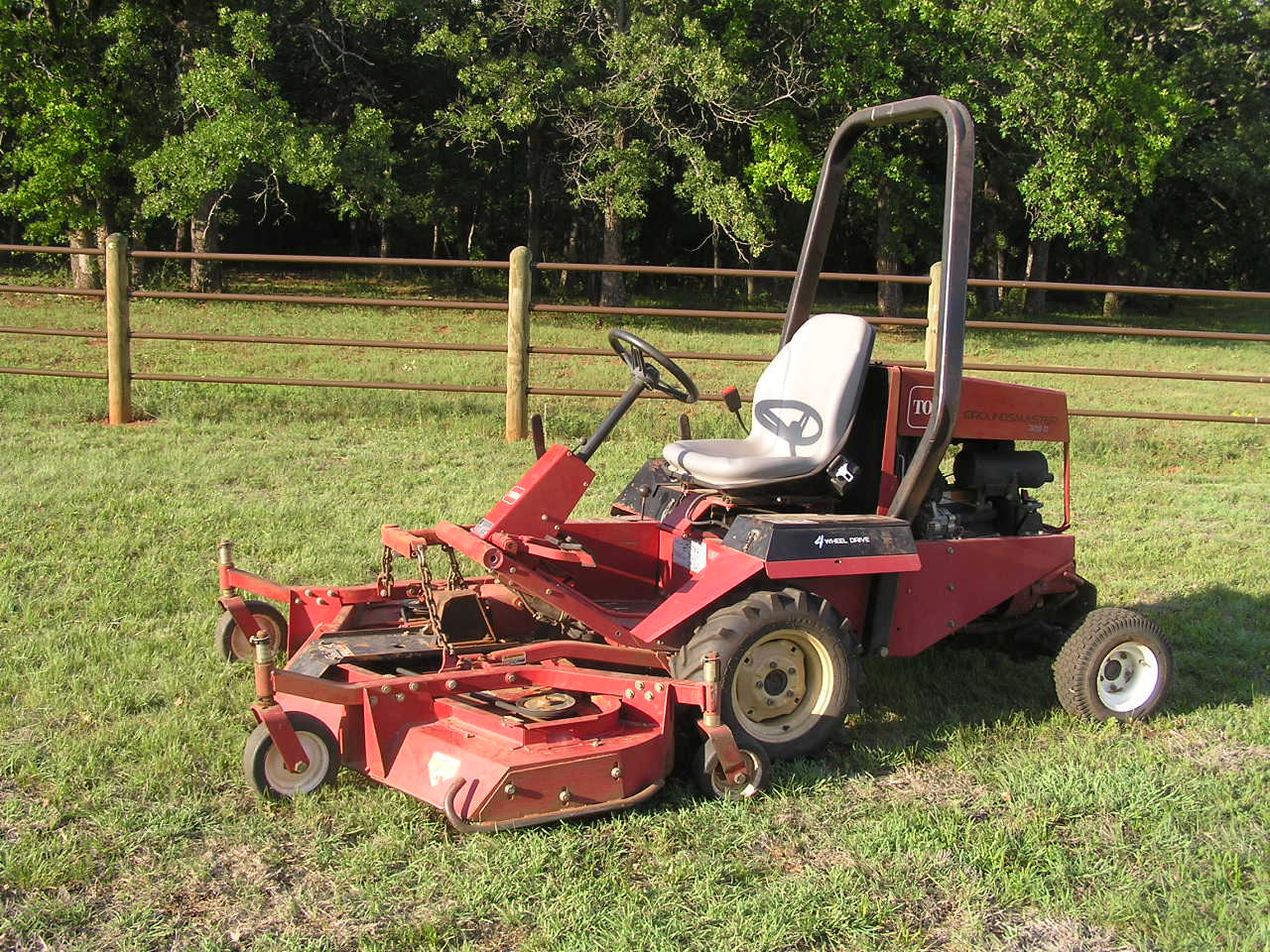

After you get a new hose for it, put a LocknLube coupler on the hose :thumbsup:.
Here is mine.
Read all about it here: http://www.tractorbynet.com/forums/oil-fuel-lubricants/304889-locknlube-cupler-grease-gun.html
And here: http://www.tractorbynet.com/forums/owning-operating/307933-review-locknlube-grease-gun-coupler.html
Used it on the wheels on the mower deck today. Raised the deck, locked it on, started pumping while moving the gun back and forth causing the wheel to rotate a half turn back and forth. Made it easy to see the grease come out around the axle.
