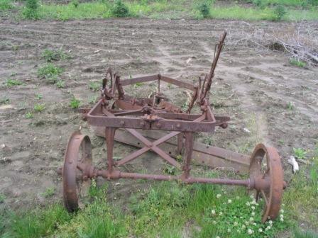

I have this old horse drawn grader and it looks like a good copy to make up a hydraulic one. What do you think?

Do some searching and you should find new " tractor pull graders " that could also be used as a model. The harows look good. A new set like that cost about $600 can.
Egon
   / Old grader #5
I've heard guys say that the rear ends of these were light (especially if you remove the human ballast!) and tended to walk when the blade is angled.
It can be modified to weight it down........
Ron
   / Old grader #6
I used to have one (bigger wheels and 2 big 'wheel's on it to raise and lower the blade). Always thought I should remove the front wheels (it was horse drawn once too) and fix the front to the tractor drawbar. Never did, but it can do a good job of levelling. The comment it is light in the shorts is right on, and adding a person wouldn't change that enough. If the wheels can take it, add 500 - 1000 pounds along with your hyd. rams for tilt at least, angle if it works out, and then rely on the drawbar being a 3pt drawbar to control depth of cut.

I still have the front wheels and seat(which is on my potato planter). this old thing used a ring like on newer graders but I think I will build one with a longer wheelbase because i don't want to butcher this one. There are good ideas on this thing that I will copy and put on the one I build.

If you could find an old worn out motor grader you might be able to get some good blade control parts.
