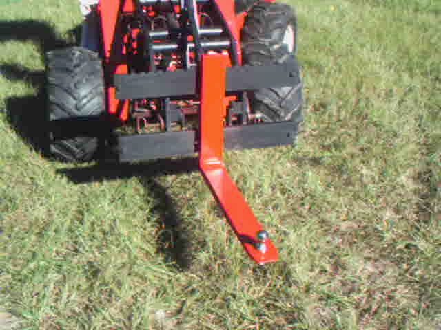

If you get those forks, try and obtain a frame for the forks from a fork lift place and adapt it to your lift arms.
Here is what I did. This pic is showing a forklift frame with one fork as I was using it for towing.
You can make that frame using 1/2 in steel and cut notches in the top rail.

I had a spare set of forks that came with my old POS Clark Forklift so I made a frame for the quick disconnect on my 3510 Branson and adapted the forks.
It works great, pull the lever, drop the bucket, PU the fork system, move lever to lock.

   / Old forklift forks for tractor bucket? #10
I took a pic of my forks and adapter. It just replaces my bucket by moving a lever that moves two pins.
