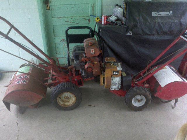

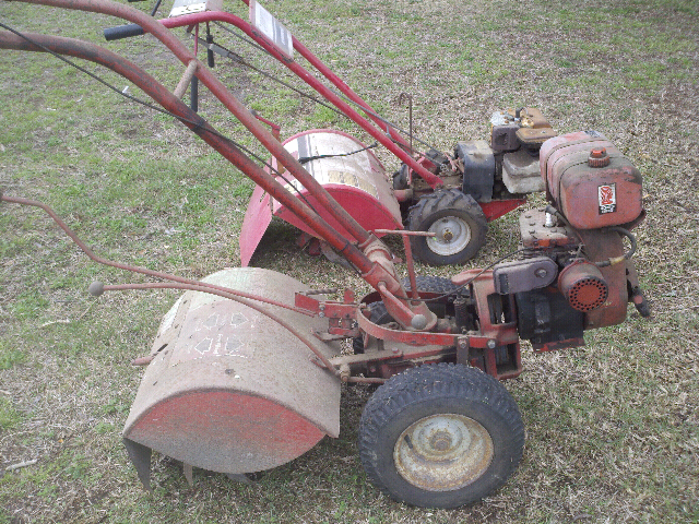

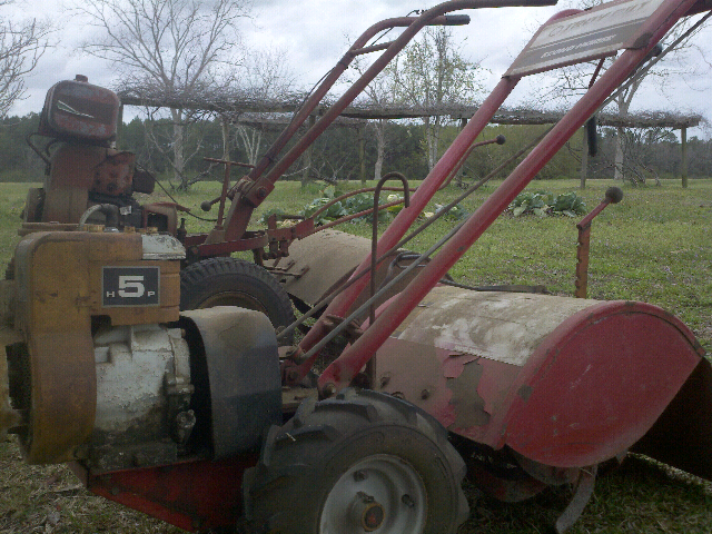

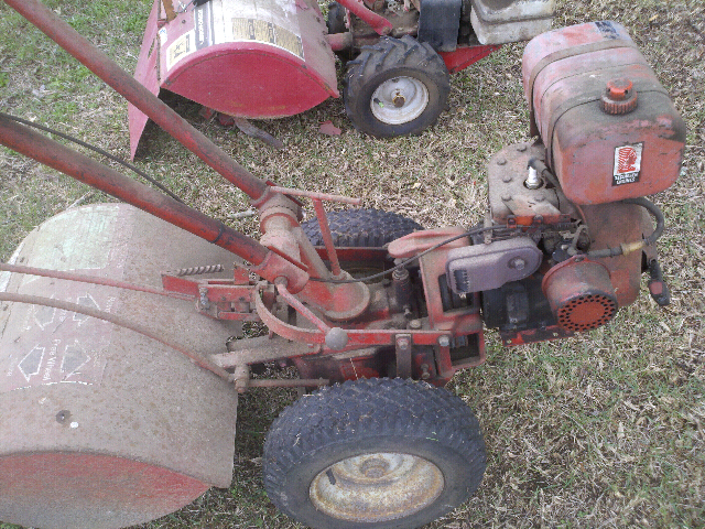

The big one runs also serial# 312660. Don't know much more about it. It's darn heavy took 3 of us to load it. Any knowledge of this model???
I have a vintage 1978 6HP Horse model that looks just like yours- -Except mine has been garaged since new and looks first class. It's all original including the tires and tines. It still starts on the second pull. I paid about $650 back then if I remember correctly. What a great product .........no wonder they went out of business......Who'd ever buy a second one?
Bet you can't get 35 years out of an MTD Troybilt today

Thank you these were in/under an old barn here in the florida panhandle. I was just tickled the big one started and ran. Swapping out tines until the rain came. Thank you so much again.

Check the gear lube in the tranmission before you do anything. After some use and abuse the axle seals and also the seal around the tine shaft will leak all the gear lube out, it happened to my fathers. He wasn't much for maintenance, but he ran the **** out of everything he owned!
Just rebuilt (2) of these tractors last fall. Put new engines on them both and did a complete seal replacment on one. Been using that one for plowing snow all winter, worked like a charm.

Taz.........YES, you got a deal. Can't tell by the pics but does the motor have one belt or two?.........Matters, for if one belt it is probably a 4 speed by changing the belt/pulley position or if 2 belts it is a 2 speed. Not really relevant for me as I run mine on the slowest pulley setting...........
For me, I would change out the tires as those on it wont get much traction in the garden. Also, it needs a depth adjustment bar there at the rear like the little one has. Yes, it matters as you set the depth that you till with it..........
Do a search for manuals and parts here on the forum.........There was LOTS of stuff posted last year about maintenance of these things and you should be able to find most all of the printed stuff with a good search or two.
DO CHANGE the fluids..........Pay particular to the levels in the drive mechanisms.........

Thanks for the input. Yeah understand about the depth bar. And all fluids. It has 2 belts. Will more than likely have to do seals on the output on the gears box. The dirt was on the gunkey side when I sprayed it off around the tines. It's interesting the tines on the little econo horse fit the big one. It's a project. Looking forward to putting in the dirt.
